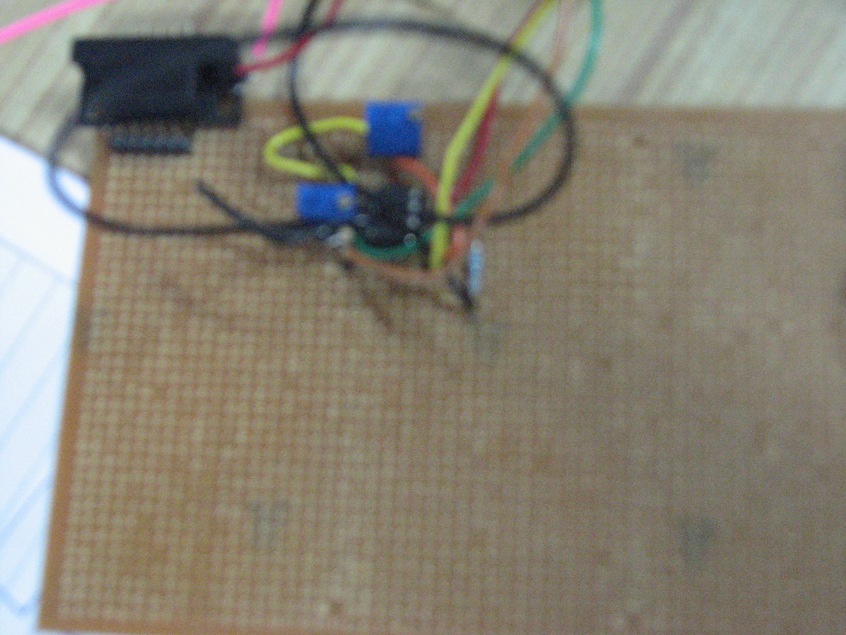

Don't build it on breadboard, they aren't suitable for much above low audio frequencies - the stray capacitance is probably causing your problem. You need a CAREFULLY designed PCB.
You may be running into slew-rate limiting. The OP37 has a maximum slew-rate of 17V/µs. The maximum slew rate of a sine-wave is 2Π*f*Vp where f is the frequency and Vp is the sine-wave peak voltage. From this the maximum peak sine-wave voltage at 1MHz is 2.7V.
The capacitance at the op amp inverting (-) junction is critical, so minimize that by keeping all connections (resistor leads, etc.) to that point as short as possible.

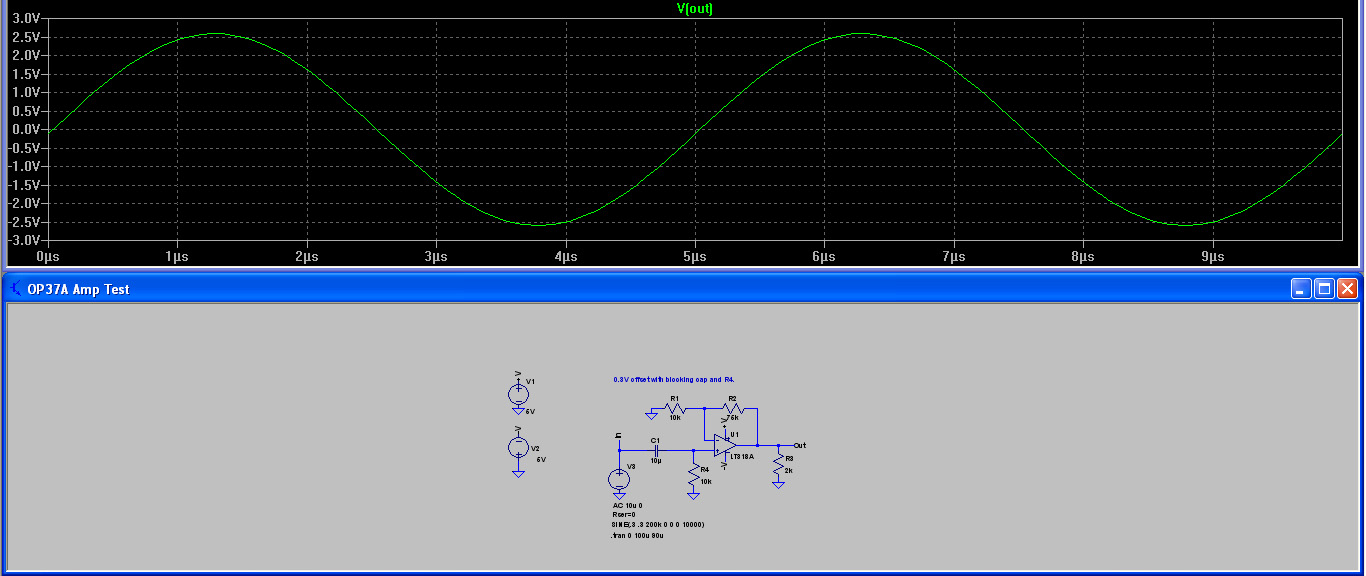

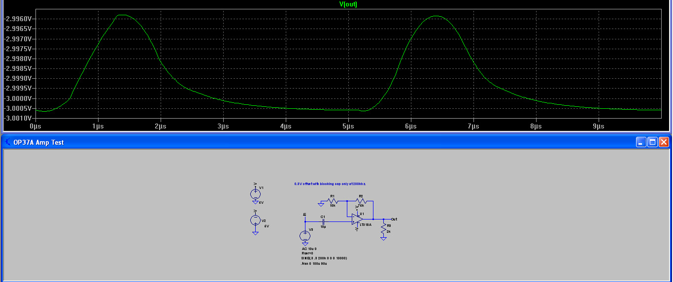

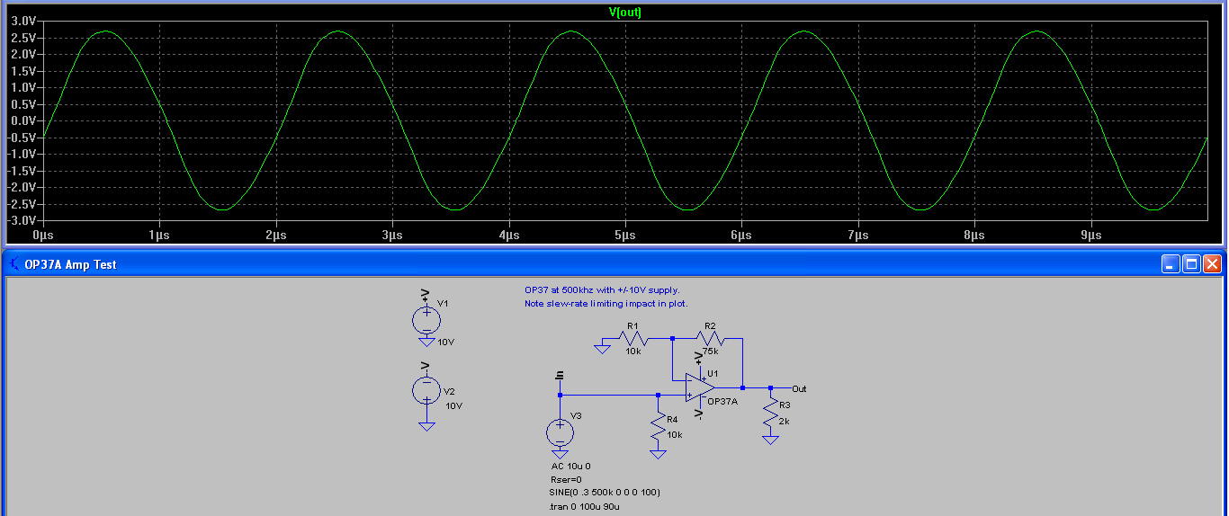

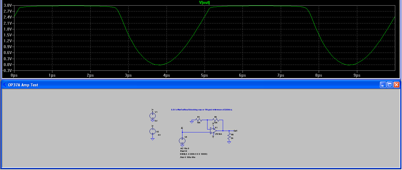

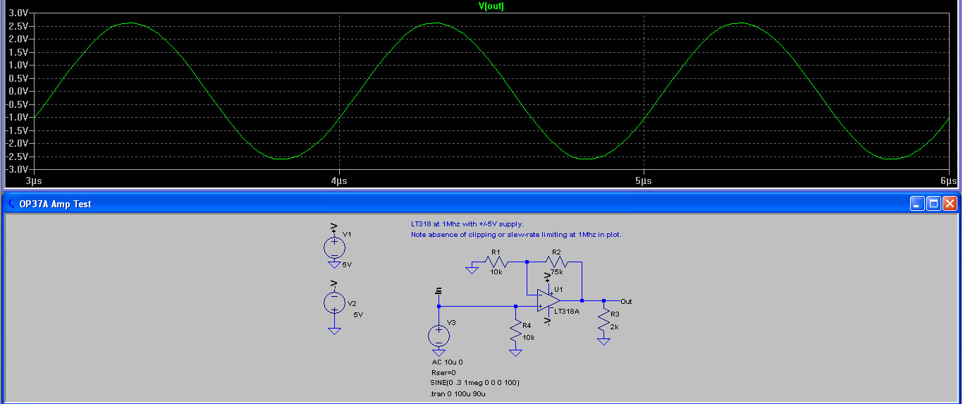

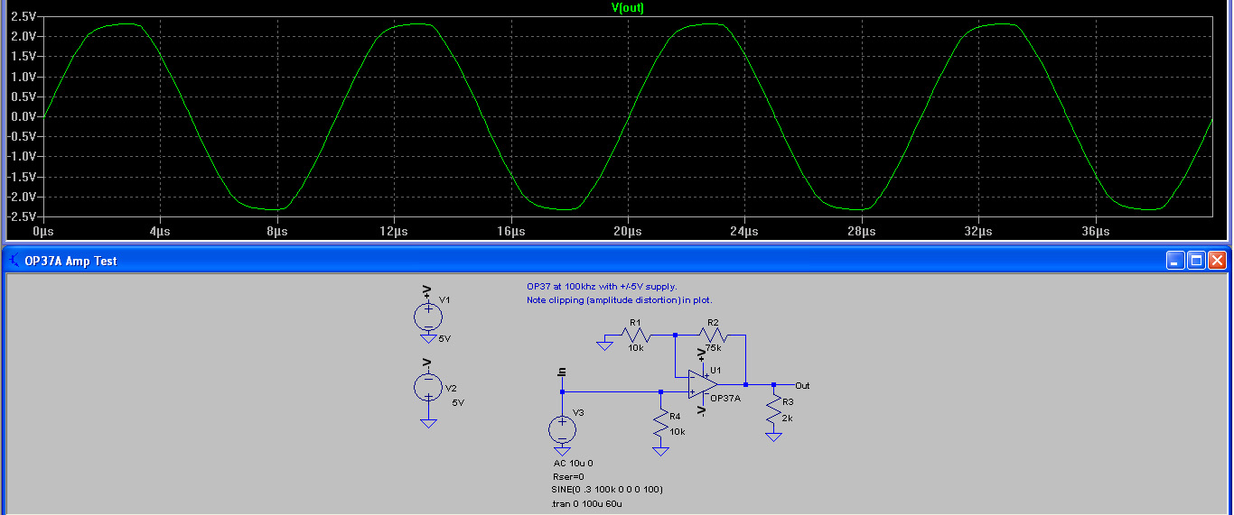

Your added information filled in the necessary blanks. I did a simulation with the OP37 and found that it does not accomodate gains of 8.5 with supply voltages of +/-5V at any frequency; the OP37 is not a rail-rail device and clipping begins at ~2.35V. Above ~400khz, slew-rate limiting limits the response and amplitude as crutschow noted. Testing with a supply of +/-10V, there is no problem up to ~400khz.
Testing the circuit on a breadboard adds a host of variables/problems as Mr. Goodwin noted. I found an entire octave difference between your emperical results and the simulation results.
I substituted a couple of other op amps in place of the OP37 in the simulation. The AD8029 should work fine, but the spice model from AD didn't work well
(at any freq.). The second was the LT318, which worked fine over the entire range with the +/-5V supply, being a rail-rail device.
Attached are three examples of the sims mentioned above.

I have taken a look at the simulation that u did. Will u pls tell me the reason for connecting R3 and R4 in the circuit diagram.
the waveforms were surprising although. at 100Khz, it showed clipping and 500Khz , it showed a decent sinewave.
whats is slew rate distortion? and why the shape of sinewave improve after 100KHz?

The limitations of any amp will appear at the output when developed. Since the configuration is voltage feedback the distortion will appear at the inverting pin given the output is being feed back to that point.

Note that the graph is for maximum output swing with the supply voltage at +/-15V. The drop from ~200khz displays the area above the curve of slew-rate limiting at maximum signal level out. It involves the rise of the signal in V/us. The greater the rise (Volts) per unit of time (usec) the quicker the amp must respond else it will not reproduce the input faithfully. By way of an extreme example, a 2V peak sinusoidal signal at 200khz takes ~5.4us to rise to 1V, but a 200V peak signal at the same 200khz will rise to 100V in that time.
Your problems resulted in the supply voltage being too low given the gain for the input level along with the limitations of the amp at any frequency, the parasitic reactances of the breadboard construction and the slew-rate limiting at higher frequencies, a trifecta of issues.
Also, i tested opamp in buffer config. in that using input voltage of 0.6V from a std. function gen, i got output at all the frequencies whereas voltage of 4V from a std. function gen showed same problems after 200KHz.
The difference being too much drive in the second instance right along with the breadboard issues, I'm sure. One cannot believe test results from a circuit on a breadboard above ~50khz for some and much lower for others such as filters.
R3 is a load resistor selected for the parameters given in the datasheet as references. See page 3 & 4 for test load for max voltage swing and slew-rate. Also see the graph for load response curve (TCP 21) on page 9. R4 is there for two reasons. One is to mitigate any input offset voltage (an old-school hangover from the early days, which I didn't change to match Rf (R2) and to develop the signal at the non-inverting input. Your initial data included a DC offset of 0.3V, which needed to be blocked. Any blocking capacitor without a ground path would likely yield unsavory results. I'll try to remember to include the delta with a sim.
the waveforms were surprising although. at 100Khz, it showed clipping and 500Khz , it showed a decent sinewave. whats is slew rate distortion? and why the shape of sinewave improve after 100KHz?
Again, i would appreciate the time and effort u put in doing these things and giving valuable suggestions about ad8029,LT318!!!!
Yes, the first sim at 100khz displayed the clipping with the +/-5V supply. The middle sim was intended to display two things with the +/-10V supply. First, there was no clipping because there was enough V overhead to eliminate that possibility. Second, that was far from a decent sine wave. It was intended to highlight the effect of slew-rate limiting at 500khz. Look closely for the effect...it is not fully sinusoidal.

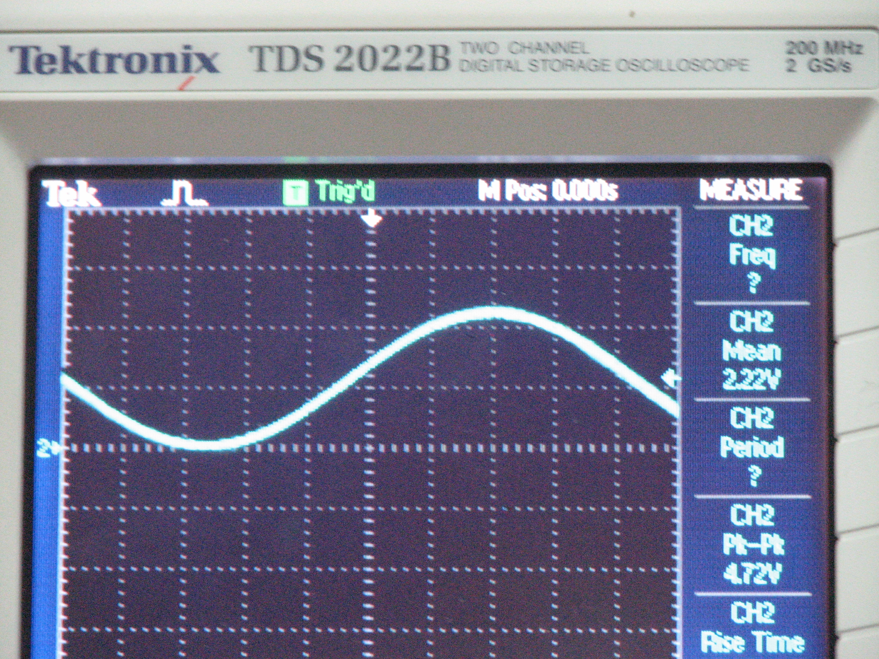

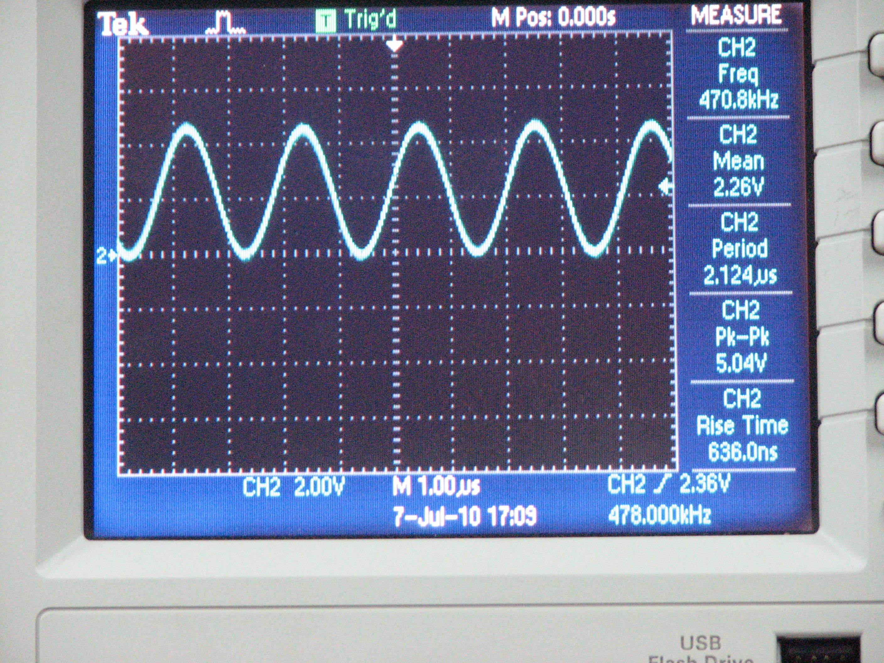

ok Merv, I have attached the files (jpg images of the DSO). Since I do not have LT318, the testing is carried out on Op37. The circuit is same just that the input capacitor is not placed since I want to test with offset voltage so the capacitor is not connected but load resistance and an extra feedback compansation resistance is connected. Anyways the circuit gave same output whether or not those 2 resistances are connected. Also, i got the same results of the circuit implemented on breadboard as well as on general purpose PCB. This testing was done just to check the point you mentioned on 5th July at 5.20 am--->"Your problems resulted in the supply voltage being too low given the gain for the input level along with the limitations of the amp at any frequency, the parasitic reactances of the breadboard construction and the slew-rate limiting at higher frequencies, a trifecta of issues."
Getting back to the description again:
input voltage 0.3V offset sinewave with a (p-p) as 0.6V. Supply voltage was 12V.
at 200khz, we got expected output. = 4.7V as shown in the first jpg image at 200KHz. When the image was captured, the DSO was processing, but signal generator output was 200KHz.
Now, i increased input freq to 470KHz and I got 5V output as indicated in 2nd post. It is a significant increase in the amplitude but do not know the reason why.. and after 550-600KHz, the waveform was not sinewave as u indicated (slewrate limitation) in the figures. Third figure (slightly blurred) is just to show u that we did it on PCB not on breadboard.

Well, you have handled one of the three issues; the +/-12V supply rails. That leaves two issues to overcome.
The first is OP37 will not work for the application you have outlined with that gain. There is no purpose to continue testing it even with the proper layout on a dedicated PCB except, perhaps, to validate its limitations based on your requirements. The second is your layout as displayed in your picture. Simply getting it moved from a breadboard to a perf board is not going to solve that issue. I see a host of flying leads for one, and is that the feedback resistor at the lower right of the assembly? Don't take this as anything but constructive criticism. The layout and that board simply add problems and confusion for yourself. The only way to get proper evaluation results is with a device capable of producing an output within the desired parameters, and that includes a layout capable of allowing the device to perform up to the manufacturers specifications for the device chosen.
I strongly suggest you look at the AD datasheets below, and read the pages listed. They cover many of the DESIGN PCB requirements for the two devices you mentioned. You should see that the construction in your photograph falls far from the mark with the use of a perf board, all those flying leads, component placement, etc.

Yes, I understood that OP 37 will not work for my application. But want to know one more thing that I found during testing as per my yesterday's post at 10 PM
"input voltage 0.3V offset sinewave with a (p-p) as 0.6V. Supply voltage was 12V.
Now, i increased input freq to 470KHz and I got 5V output as indicated in 2nd post. It is a significant increase in the amplitude and are you able to interpret the reason for that. If so, please let me know about it. And after 550-600KHz, the waveform was not sinewave as u indicated (slewrate limitation) in the figures. "
I am doing this testing because, such sudden voltage amplification should not occur with other opamp and trying to understand the reason behind it. If, the reason is understood, either the circuit can be adjusted for my application or an opamp can be selected properly.

I will be clear to the point of bluntness. The circuit, as constructed and which I discussed in my previous post, is a prime example of horrible workmanship in a layout and the materials used; the methodology employed is amateurish to the extreme. There is no mystery to the mid-range peaking considering now that I understand Rf is a multi-turn pot with flying leads to the amp; something I could not see in the blurred photograph.
You need to read and understand my last post AND go to the links I posted there AND read and understand the PCB layout recommendations on the pages I noted. Then construct the circuit according to those advisements regardless of which amp is selected.
I tried to make those points in my last post in a more pleasant manner, but it didn't get through.
Here is something to try that should bring those points home for your own experience. Set your existing circuit up at maximum peaking of the signal (575khz?). Then grasp those flying leads with your thumb and forefinger. Look for changes in the display. Then move and bend the wires and look for changes in the display. Then pass your hand over the circuit as close as you can without touching anything and again note any change in the display. Pay close attention to those wires/connections to the inverting input. You might be surprised with the results you observe.
Merv
