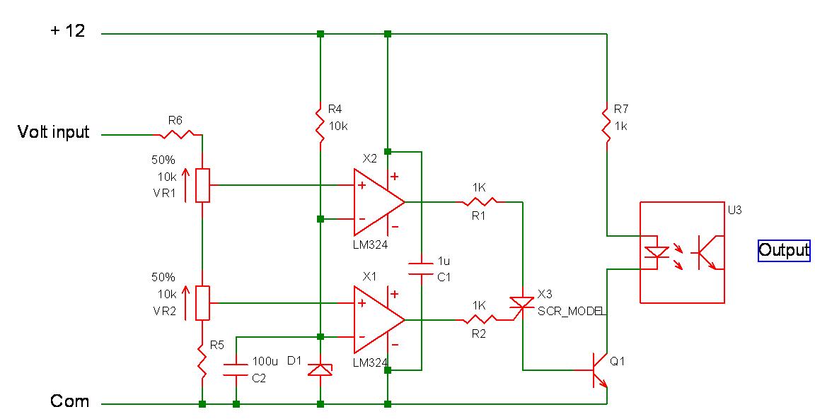

YOU could run two ATX units. One set up at the float charge voltage and the other set for peak charging. By using a window toggling circuit like this one pictured below.
You would have it turn on the peak charger if the battery voltage got pulled down below a certain point and then charge up to the peak voltage and shut off.
