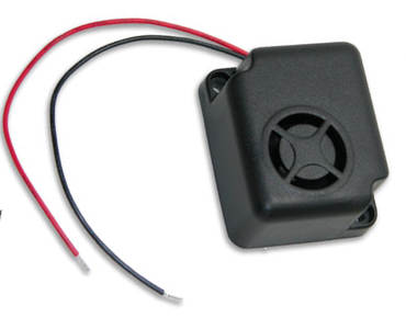

A piezo siren. You can buy them at most electronic retailers. This particular one would sound like a car alarm. 100dB at 1 metre.
Thanks. I'll look for some piezo siren options. Would there be a simple way to control the volume with a mcu? I'd like to be able to configure low/med/high volume options.
