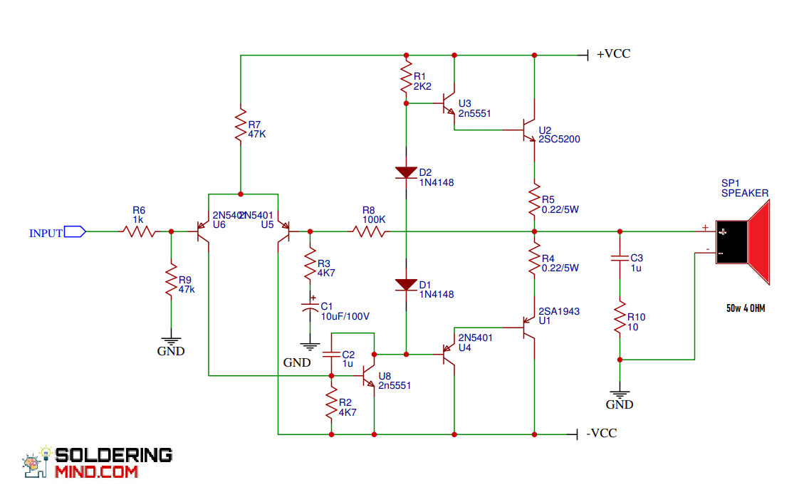

I need some help making sure this is a good circuit to go by.
I know it's probably not the greatest, but would is it efficient enough? Will it even work as intended.
This is a friend's project I am just helping him with it. He wants around 200 watt capability.

The amplifier circuit from India has errors:
1) Its maximum output is only 45W into 4 ohms.

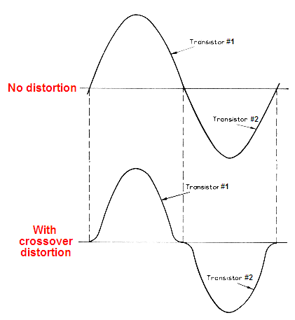

2) It is not biased correctly so it will produce awful crossover distortion all the time.
3) Its capacitor C2 has such a high value that it will kill most audio frequencies.
4) It has no detailed audio specs.
AliExpress has a 100W amplifier using the same transistors but it has more parts so it might work better. It is already assembled but is missing a heatsink.
It also has no detailed audio specs.

As AG says, it's a completely useless circuit, really poorly 'designed' (and I use that word VERY loosely) by someone who doesn't have a clue what he's doing.
One point AG didn't mention, is a complete lack of bootstrapping, which will further reduce it's power ouput and severely increase distortion at high volume - possibly in order to match the high distortion already present at low volumes? :D
For a couple of suitable simple designs, have a look here:
They are both pretty similar.
C2 is at least 3 orders of magnitude too large... unless the goal is to only amplify subsonics..... R1 should be replaced by a bootstrap or constant current source... u3 and u4 emitters should be connected together with a 1 to 4k7 resistor... most designs of this type favor 1k... this improves the slew rate by providing a discharge path for the miller capacitances of u1 and u2... it also provides some isolation for u3 and u4 if one of the output devices shorts (compared to the older method of running the driver emitter resistors to the output terminal). d1 and d2 don't provide enough voltage drop to forward bias the 4 pn junctions of u3, u2, u1, and u4. old school amplifiers used stacks of 3 diodes and a variable resistor, more modern amps have a transistor connected as a "variable zener", and the diodes or transistor should be mounted to the heatsink the output devices are on. lastly C3 is, like C2 way too big... that RC network is usually 10 ohms and 1 nF (nanofarad, not microfarad).... this schematic looks like schematics posted by companies that sell kits, and so it contains a few "easter eggs" so you have to buy the kit to get the correct schematic and correct parts...
There's so much junk like this online. The goal was to make an amp ourselves without a kit. It's looking like homemade amplifiers are a little out of reach at the time. Your right though this schematic is kinda fishy.
