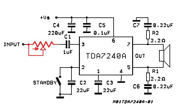

OK I checked out the TDA7240A and it's time for some stupid questions. First off, how would I dynamically vary the power output (i.e. volume control). Also, how do I calculate what the total current draw of the device will be for a given power output? Is it as simple as dividing the power output by the supply voltage (I = P/V)? I know that would be assuming that the device is 100% efficient but that should give me a ball park idea right? Thanks.
Simply connect a 20k to 100k log volume control to the input of the input capacitor for a volume control.
The TDA7240A amplifier IC is about 58% efficient at clipping. When its output is at 15W into a 4 ohm load then its heating is 11W. Its total power is 26W which is a current of 1.9A from 13.8V.
Like this? Also, after checking out the efficiency vs power output graph in the datasheet, it seems like this amp might be overkill. I am only powering a single 5W speaker. At 5W output, the efficieny drops to ~ 35%. Is there a similar amp out there you could suggest that's rated for a lower power output and would be more efficient in the 5W range? Thanks.

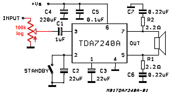

No.
Your pot is a rheostat that changes the volume only slightly.
A volume control must be a variable voltage divider like this:

Ahhh, I understand now. Also, I edited my last post. Did you see the question about suggesting an alternate amp? Thanks.
