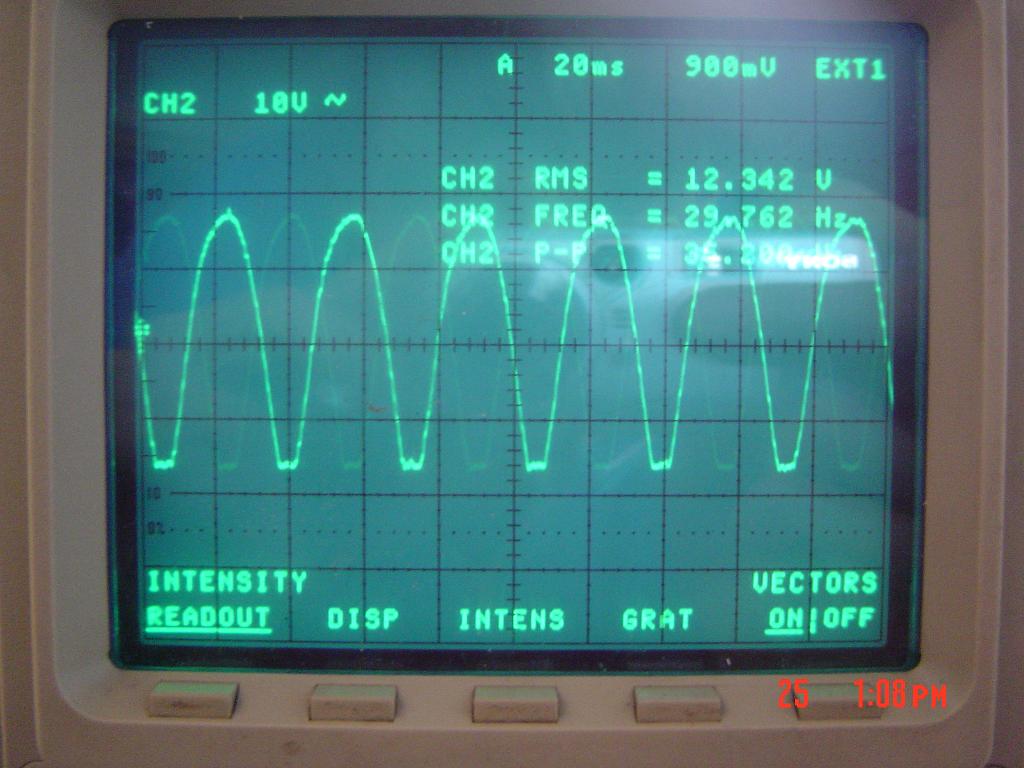

Well I got some results: sorry about the glare, and picture size, my
MS paint program was deleted somehow.
I believe that is reading 35.2V P-P. So that's pretty close to what you were saying Nigel.
Is there a typical test frequency that they would use?
Hi Jeff,
It looks awfully distorted. All the bridged amps I've seen have a symmetrical waveform on each wire. Yours is badly off-center.
Hey, your load isn't from one wire to ground, is it? That's where your 'scope probe should be. The amp's load should be connected between each output connector like a speaker.
If the load wasn't connected where it is supposed to be, the measurement doesn't mean anything.
It was just simple maths :oops:
So that makes your amplifier look like 500W RMS in to 1 ohm, based on 175W RMS in to 4 ohms.
Usually 1KHz, or for a 'proper' test, use spot frequencies through out the audio band. As your amp is being used as a sub-woofer, using 30Hz sounds a reasonable frequency to use - personally I'd have 'chickened out' and used 1KHz though :D

Well I did some more messing around. I set my scope to DC coupling and turned the volume all the way down on the cd player. There is a 24VDC offset with my probe connected to either of the speaker terminals and ground.
whats up with that?
maybe this is why the wavefrom is funny looking?
I'm gonna try to isolate my scope from the amp by using a small transformer.
Also, the amp is only 1 channel, so there really isnt anything to 'bridge'.
