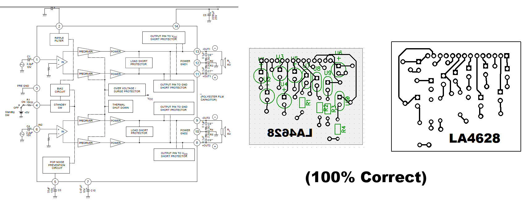

Here it is the PCB of Audio Amplifier LA4628 IC as per the datasheet. It is 100% correct ! Please no comments !

One big problem you have is that you do not understand the English language.

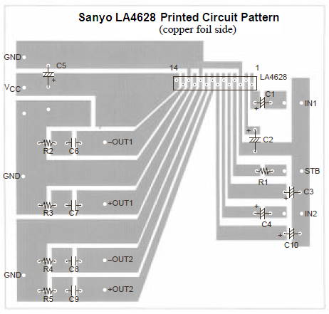

You show the schematic not the PCB (printed circuit board).
I show here the PCB from the datasheet and it is completely different to yours. So yours probably won't work and the parts might not fit on it.

I am showing the schematic and PCB simultaneously if you look at the picture attachment you may understand it ! But one problem for you that you don't understand me ! Only God knows when you understand me !
Learning your back and up to your old tricks I see. Why do you keep posting these amps. If you know this one is right than why did you post it. Now we will have to tell you its not right just so that no one trys to make this from your poor incomplete layout. You have many small problums with your layout and one over site that will prevent it from working at all.
So a warning to anyone eles reading this....it will not work!!!!!! and is far from being "100% correct"

That would be good, in the meantime stop posting bad layouts that you say are good.
I am asking yours for the definitions about good layout. If I submit my audio amp layouts in this forum then if it does not permit the rules of the good layouts I will no longer visit this forum anymore. But my works will go on whatever the people like your say about myself................................
learning: If you think your layout is perfect (and, I believe it is, thousands wouldn't, but I do!), than build the thing allready and post your results here. E
Learning, post a video of you trying to straighten the 14 pins on the IC from the two rows it is made with into the single row on your pcb.
Show us how you can cram the huge capacitors into the tiny spaces you have for them.
Show the smoke and maybe red-hot printed wires on the pcb because some are much too narrow to carry the high currents.
Post a recording of the extreme distortion caused by the circuit oscillating.

Aw yes but thare is something vary important missing from that layout. Can you tell what it is? Andy
functionality?
Yes in post #4, I said it would not work the way it is.
It appears that learning has gotten some other help and now may know whats wrong with his layout. lets see if he will admit that his "100% correct" layout is wrong. Andy
