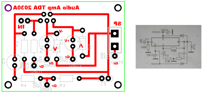

Please put your views about this audio amplifier TDA2030A whether its circuitry is correct or not !

The schematic on the datasheet has more parts than your simple circuit.
Some of the traces on its recommended pcb are much thicker than yours so they are able to carry the high currents that yours cannot carry.
The recommended schematic and recommended pcb design are shown on the datasheets for most audio amp ICs.
You should not make an amplifier if you don't have the datasheet from the manufacturer of the IC.
Does your government block you from downloading "Western" datasheets?

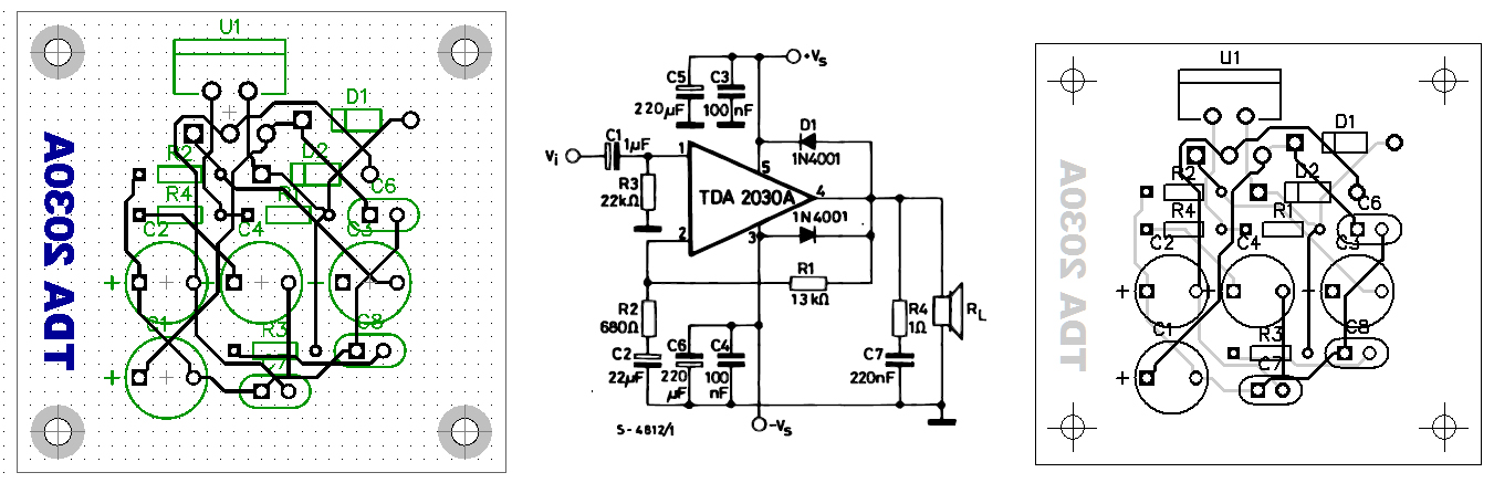

Here it is revised PCB of TDA 2030A as per the datasheet. Please tell me about it !
Thank you !

What the............. that looks nothing like the layout from the data sheet!
You are not learning anything.

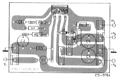

Your pcb is double-sided and has many skinny little traces that will immediately burn out when they have 3.5A in them.
The datasheet has a much simpler single-sided pcb that has very thick traces so they do not burn out.
Why don't you look at the datasheets for all these amplifiers you are making pcbs for??
Why are you randomly making pcbs for millions of amplifiers??
