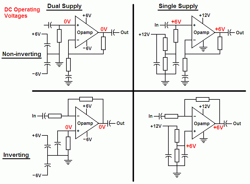

Any opamp can be operated with a single supply if its inputs are connected to a voltage divider at about half the supply voltage. Here is an example:
