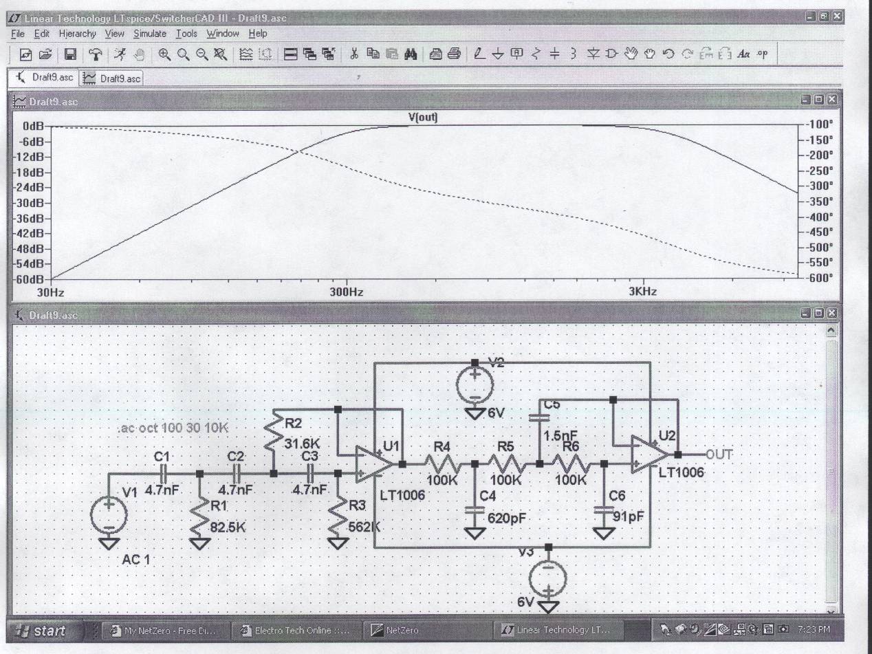

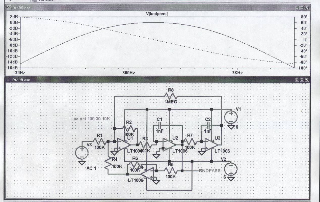

Does anyone have a schematic to build an audio filter that will reduce any background noise outside of 300 Hz to 3500 Hz picked up through a directional microphone?

So you need a bandpass filter... Try google.. Example filter designs are everywhere...
5% tolerance will work. You will want to use a less expensive op amp.

2-pole filters are kinda droopy, aren't they.
