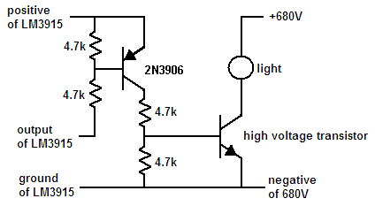

So you need a bunch of high voltage switches that are driven from the LM3915. Small relays would switch slowly and are not rated for such a high voltage.
sorry if it's a pain in the butt, but could you give me an example of such switches? and how would i connect it? would they interrupt the -negative line to the lights?
Since the lights have a negative line then DC must be used so a transistor can switch them. A transistor cannot switch AC.
Each light needs a circuit like this from each output of the LM3915:

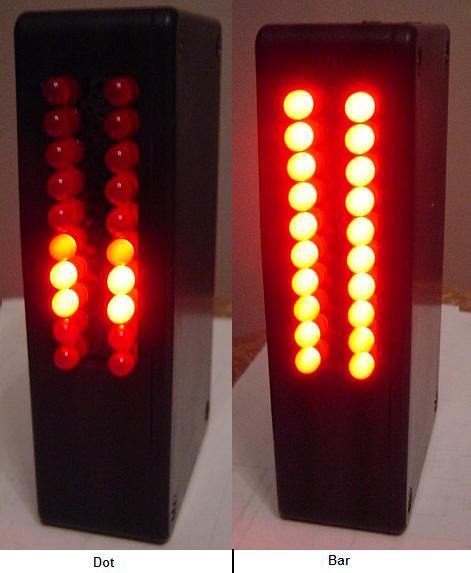

I made this sound level bar-graph with an LM3915 and some LEDs. It has a microphone and a rechargable battery.

An inverter uses a power supply of 12VDC and makes an output of 680V probably AC.
so what kind of IC would I need for this kindof thing?
If the inverter's high voltage output is AC then it might be able to be switched with a high voltage triac instead of a transistor.
