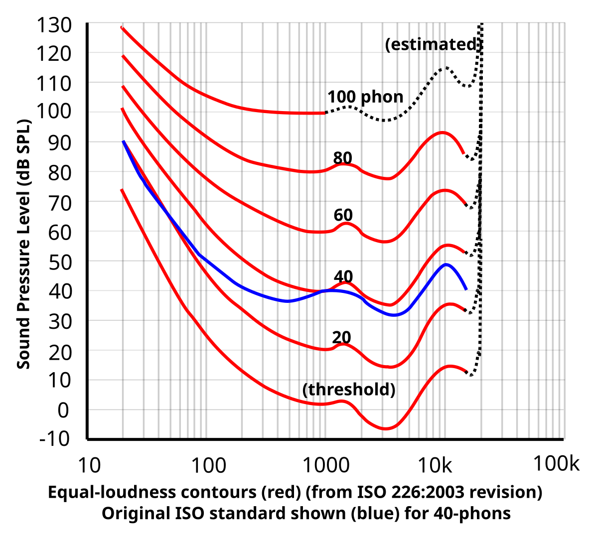

It appears then that technically you will have to do some filtering to split the result in to different frequency bands and use the previous calibration data to work out the SPL in each band, then do some interesting(!) maths to convert to a Sone result...
However, for something which I'd guess is quite a low level sound, you could probably use and inverse equal-loudness curve in a graphic equaliser to compensate for ear response, plus the calibration SPL to get a result?
Or just use a metering plugin that has a "LUFS" display option - that should include the human ear response calculation stuff already...
