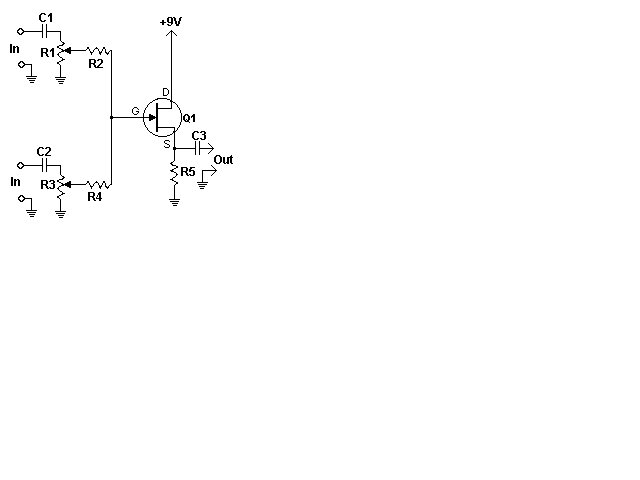

hi
this circuit is an audio mixer.... i can beleive that but can someone explain to me how??
i have an idea i hope its right ,,, and if im wrong plz correct me::::
The input node works as a current adder and then the total current is amplified by the transistor

This shows an N-channel JFET. My understanding is this device is not current controlled but voltage controlled Vg-s and is symmetric from D-S.
Since no current flows into the gate, the current flowing in R2 is equal to that of R4. This current is I = (a*Vin1 - b*Vin2)/(R2+R4) where Vin1 and Vin2 are the two inputs respectivly and a & b are scale factors from the input divider network (assuming C coupler is good short).
This current produces a voltage at the gate via the R2 (or R4) drop. This voltage (work the math) will be a scaled sum (or difference) of the two inputs Vin1 & Vin2. Vg = aVin1 - I*R2.
So it does sum the voltages and I suspect that with a properly biased JFET (Doesnt look biased to me) this voltage will be amplified at the output via the source resistor. I'm no expert with mixer circuits, but this seems like a crude circuit.. Someone else on here can likely provide better insight.
R2 and R4 mix the inputs simply because they are connected together. You make a mono (L + R) signal from a stereo source the same, with a resistor from each channel then the resistors are connected together.
The entire circuit works with voltage, not current.
The transistor isn't an amplifier, it is a follower with a small loss.
With the volume controls at maximum, if the same signal appears on both inputs, the output is a little less than the inputs. If only one input has a signal, the output is a little less than half of the input since the resistors are a voltage divider.
The volume controls affect each other, unlike a "real" mixer where the volume controls are completely independent.

No, The JFET in this circuit is a follower and doesn't amplify. The more inputs that this mixer has, the lower its output level.

Yes, it's a REALLY CRAP 'design' - not recommended at all!. By far the easiest way to make a mixer is a simple opamp, as a virtual earth mixer.
Optikon said:
I suspect that with a properly biased JFET (Doesnt look biased to me).
It has (or might have) self-bias. I was trying to figure out its biasing, but a 2N3819 FET has such a wide range of unbiased current and cutoff voltage that I think many FETs won't even work in this REALLY CRAP 'design'.

If you bias the gate at a few volts and end-up with a 2N3819 FET that is close to its cutoff voltage limit of 8V, then this circuit won't work from a 9V supply.

This is a FET, it doesn't have input current. You are correct, the leakage current is small and is typically only 0.002nA, which would cause a bias voltage shift across two of the mixer's 10K variable resistors of only 0.01mV. Its maximum leakage current is 2nA which would cause a bias voltage shift of only 10mV. The leakage current is rated at 15V and will be much less at the few volts in the mixer project.
