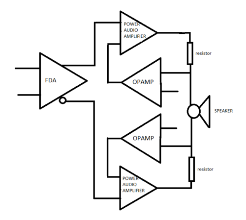

Hello everybody .
I'm about to make a very specific request, I need help
to understand if it is a feasible idea as I thought it and try to complete the circuit.
as the title suggests it is an audio power amplifier, the image you see is not to be considered a diagram because other components are missing but it serves as an aid to understanding what I want if words were not enough.
we see an FDA driving 2 bridged power audio chips, the feedback of the latter is made by 1 opamp per branch instead of the usual 2 resistors in series that go to ground.
this feedback must have a precise function, the
loudspeaker current drive .
the concept is to increase the voltage of the amplifier when the impedance of the loudspeaker increases in order to obtain a balance and a constant current, the task of the 2 resistors in series with the loudspeaker, with a value equal to 0.1 Ohm or even less , is to allow the 2 opamps to create a feedback . when the speaker impedance increases the voltage across the 2 resistors decreases and at that point the 2 opamps via feedback must increase the output voltage of the 2 bridged power chips.
why bridge? . because I can get twice the voltage of a ground loop amplifier.
without a bridge and with ground reference it is easier to do , but not with this system .
let's see if in this forum [unlike others] there are people able to succeed in realizing the scheme.

If the +ve amplifier is controlling the current, and the -ve amplifier is also controlling the current, you have two separate controls with only one variable, and it won't work. Component tolerances will mean that one amplifier will try to make more current flow than other one, and you will get a fight between one controller and the other.
If you want to run the amplifier in a constant current mode, you should have one op-amp measuring the current, and then compare that with the input. The result would be a voltage, which should be split and fed to the two amplifiers as a voltage set-point.
I do not agree .
the fact that the components of the two legs cannot be identical will result in two slightly different voltages at the output of the two power amplifiers and nothing else
I do not agree .
Well the devil is in the detail, and it depends on the gain of the amplifiers.
If you have a circuit that can increase the voltage across the speaker by 10 V if the current in the speaker is too small by 1 A, each half of the circuit will increase the voltage by 5 V in response to the 1 A change.
It then follows that if there is a 1 A measurement difference between the two amplifiers, then the voltage would be 5 V higher on one side than the other.
The values of the gain and the measurement errors will affect how big the offset is. The more tightly controlled the current is, the more accurate the current measurement has to be between the two sides.

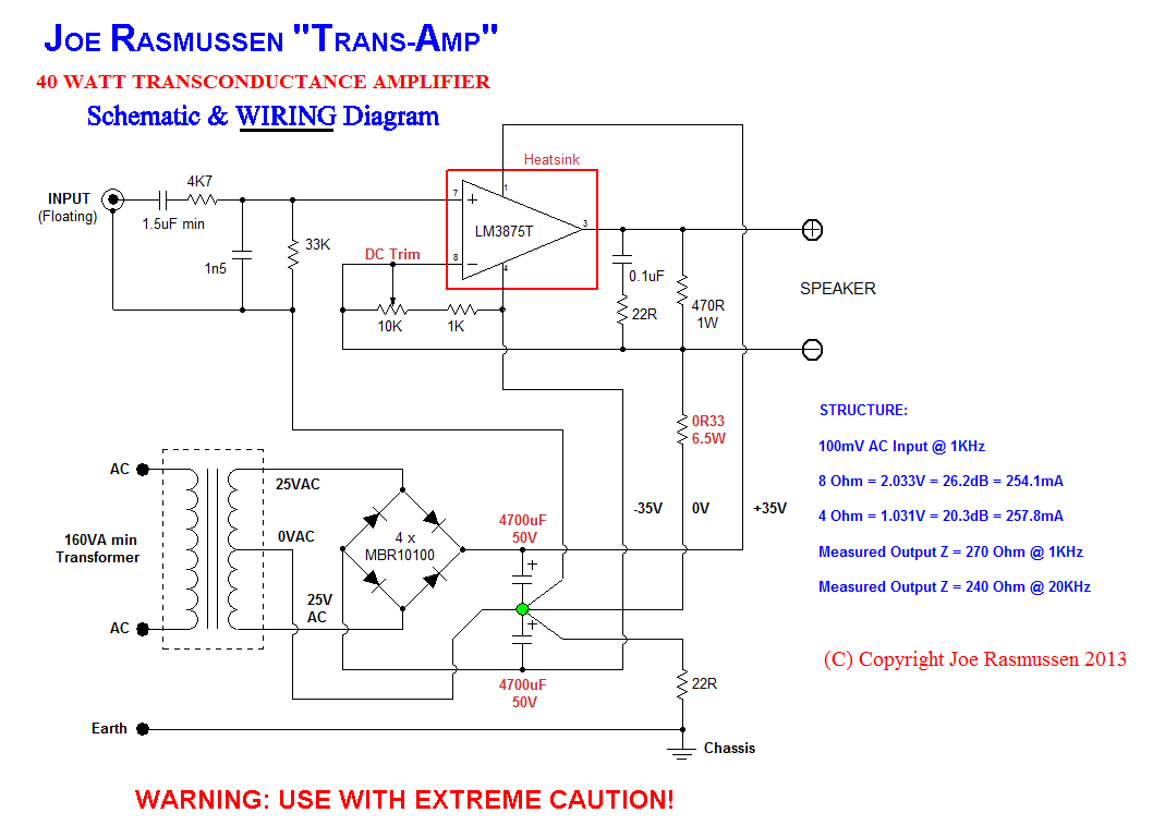

this gentleman is called Joe Rasmussen and he is certainly not the latest arrival. is related to the project below:
he uses something different from what I propose, an amplifier
to transconductance.
a kit that costs $3,000.
I don't think he worked that hard on this project to make it sound like a bongo drum.
The Rasmussen article shows an expensive but ordinary speaker, not a current-source audio amplifier.
ALL audio amplifiers are a voltage source with an extremely low output impedance. The specification is called "The Damping Factor". An expensive Crown amplifier has a damping factor of >1500 for its extremely low output impedance:
The 0.33 ohms resistor on the amplifier is a simple passive current limiter that reduces the maximum undistorted output power and softens clipping.
