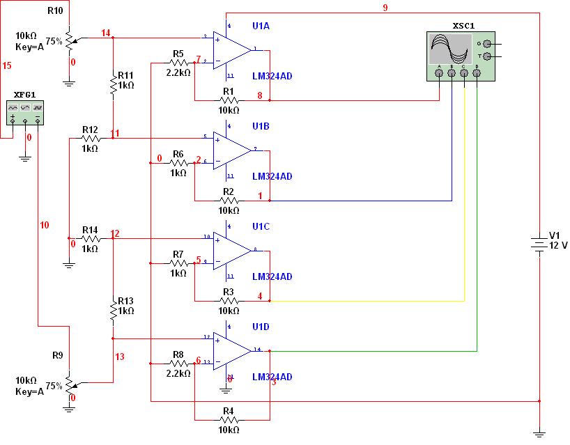

I would like to know if anyone can help me design a circuit that uses op-amps or any other kind of amplifier to take an audio signal from the left speaker and mix it with the right speaker. I have made a small one, but it's hard to calculate what the resistor value needs to be to control gain in the op-amps.
What I would like specifically is to have the audio come in and get mixed so that the signal could be sent out to a VU meter. ex: if there is a lot of music or what not in the left speaker, then the left VU meter would be higher than the right VU meter and vice verse.
The circuit I have posted, is the simple one that I made, I just can't seem to find a consistency between the gain resistors in the op-amp and the Audio level that is put in.

I cant figure out what your circuit is trying to do, but it will not work as you have drawn it unless you connect split power supplies. With the the inputs to all of the opamps referenced to 0V, the opamp supplies need +12 and -12V split supplies.
But what if the output needs to be 0V (or close to it)? You may be right, I may need to add a dual rail power supply to the schematic, but I'm not sure how that would affect it.

If it's for audio and not just a VU meter then I'd recommend using an op-amp with a wider bandwidth and faster slew rate such as the TL074.
It's not correctly configured for single supply operation. The side of R5 to R8, currently connected to 0V, should be capacitively coupled to 0V and the non-inverting inputs should be biased at half the supply voltage and capacitively coupled to the input.
The circuit will not work anyway since the opamps are not powered. If they have a single supply then the inputs of the opamps might be destroyed when the signal goes more negative than ground.

I think it is foolish to use resistors as low as 1k at the inputs to the opamps. 100k resistors will work better.

Yes they are, they're just incorrectly powered.
The schematic is confusing, it's a quad package so the + and 0V pins are connected on different op-amps but they're internally connected in the IC. The excess unused power pins should've been deleted from the other components, assuming it's possible in the CAD program he uses.
it'a kind of difficult tp piece together what you're trying to accomplish here. are you trying to make some type of VU meter that displays a rendering of the stereo "image"? if so, it's a bit more complex a problem than what you have in that schematic. what you need is a set of differential amps and summing amps, so you get 5 signals out L+R, L-R, R-L, R, and L.. you would then use op amp or resistive mixers to generate the following signals 2L-2R, 2L-R, 2L, 2L+R, 2L+2R, 2R+L, 2R, 2R-L, and 2R-2L. each of these would feed a VU meter, and give somewhat of a picture of the stereo image. it wouldn't be perfect, but it seems to be along the lines of what you're looking for.... if i guessed correctly what you're trying to do.

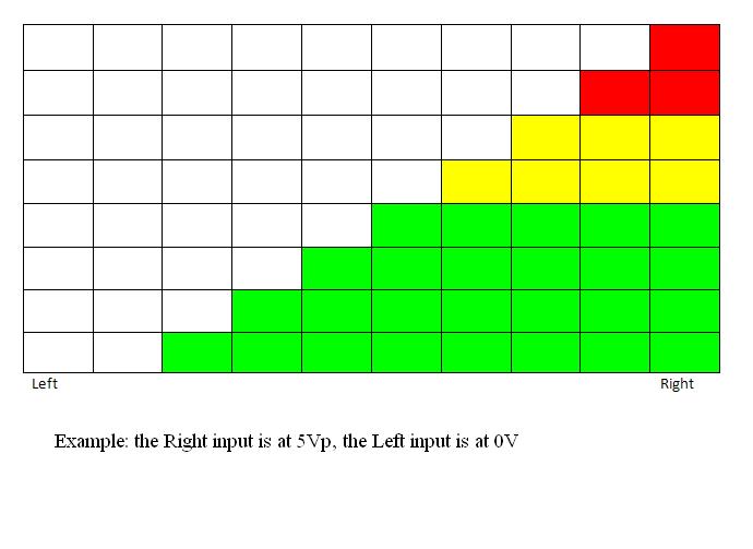

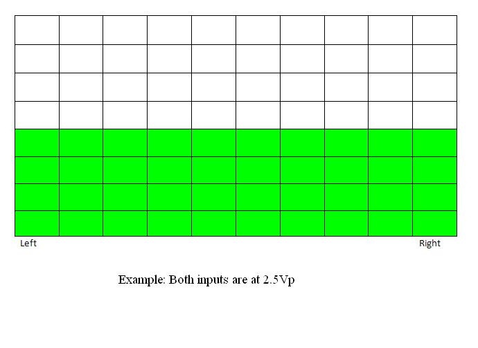

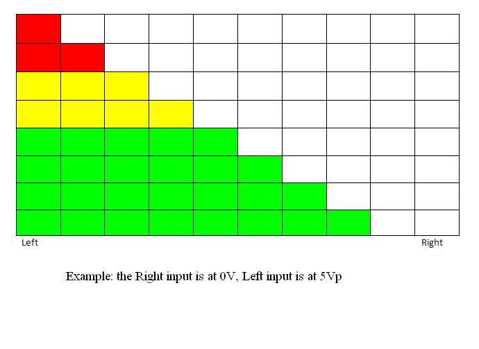

What I am trying to do is make something along the lines of an audio spectrum analyzer without the bandpass filters. (I don't know what it's called)
I have attached a few example pics of what I'm talking about.

a spectrum anayzer isn't what you're trying to make then, it's closer to what i was describing, except you wouldn't be using the difference signals beyond the 2L and 2R signals, so you would be using the 2L, 2L+R, 2L+2R, 2R+L and 2L signals. this could actually be done with a resistor ladder, and some op amps that you could trim the gain on to get all of the VU meters reading the same when you have a center channel (L+R) signal (i.e. both channels driven equally and in phase). later tonight i'll draw a schematic along those lines and you can try it.

Do you think that that would be the easiest thing to do? I'm all for simplifiying this project as much as possible. What I was origonaly going to do was something similar to what you are describing, except it required each resistor in the resistor ladder to be a different value. The way that you are describing it, all of the resistors could be the same value.
