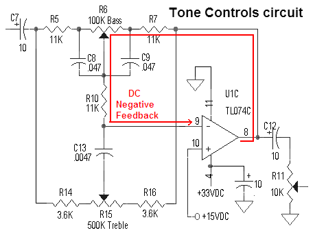

Hi!
This very old pre amp circuit I use for my transistor amp. With my transistor power amp (300W) this circuit works well. No more trouble gave me. I tried making different kind of modern pre amps. But finally I thought my old circuit is quite ok. Output gain no need to adjust unlike other pre amps, can directly connect to the power amp input.
Now I want to use this circuit with my STK amp (STK 4191). But I’m not satisfied with the sound quality (may be the cheapy STK IC have poor quality).
The headache is to adjust the BASS. Even though I change the filter capacitors near the BASS control. The BASS is starting to increase (at a feeling level) in the end of the BASS volume level. (In original systems the BASS is working in it’s fully range)
What do you think about this preamp? Can you suggest me a quality preamp (with tone control) for the STK 4191(41XX) series?
(I hope my speaker system & input signal is quite ok. STK 4191 circuit is the original circuit as SANYO specifies in the data sheet)
Thanks a lot
Hi Gayan,
Your opamp has its inverting pin without a DC voltage. It floats at any DC voltage.
It should be DC-coupled.
The 741 opamp is very old and is very noisy. Its max full output frequency is only 9Khz. A TL071 single, TL072 dual or TL074 quad opamp is low noise and has a full output frequency of 100kHz. I think a dual TL072 costs the same as a single 741 opamp.

audioguru said:
Hi Gayan,
I agree, it's a really crap circuit - and not suitable ever to be used, it's essential that there's a DC path to all inputs of the opamp.
A 741 is very old and poor, but in this circuit (assuming it was wired correctly?), it's doing nothing anyway.
Oh thanks a lot audioguru for your circuit diagram.My current circuit I have to DC coupled as you said.I'm going to make that TL07X series for my STK amps from now onwards.But the supply voltage is little bit high.Never mind.
Thanks a lot
The TL07x series of opamps work fine if the supply voltage is single, like in our examples, or if the supply has dual polarities.
The total supply voltage for the opamps can be as low as 7V or as high as 36V.
Thats really cool.I was wondering how to give supply to your pre amp 33V.It is better I can give supply from a 12V transformer(single supply).Other wise I have to add another transformer to the amp enclosure.Then the noninverting pin voltage will be going down for a 12V supply.
A 12V transformer makes unregulated 15.5VDC. Use two resistors in series to make half of it and with a filter capacitor like in your circuit for the non-inverting input.

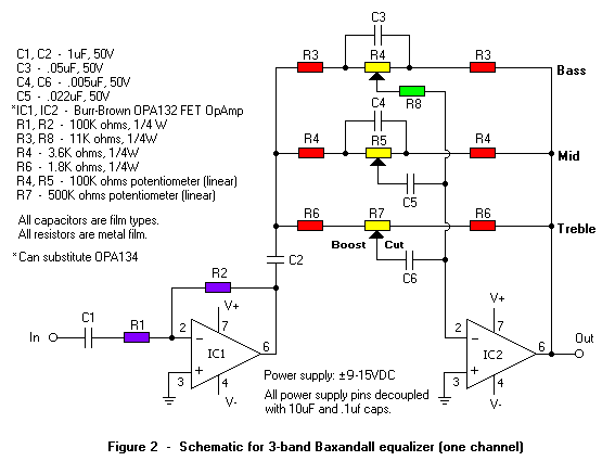

Maybe you need this 3-band tone controls circuit:
