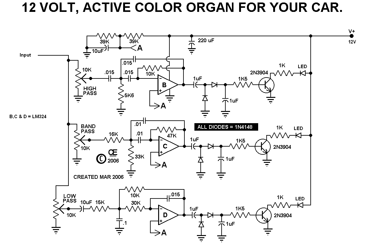

Is there a way to make certain LEDs light up at certain frequencies?
I would love to learn such filtering
You can use bandpass filters to filter the relevant frequencies to each individual led. That way you could have a green one for low frequency, blue for mid, red for high, etc. If you went for just low, mid and high frequencies you would need a low pass for the low (bass) freq, bandpass for the mid, and high pass for the high (treble) frequencies. Bandpass filters allow a certain range (BAND) of frequencies to PASS. High pass and low pass, as the names suggest, allow high and low frequencies (respectively) to pass through, blocking off all the others.
Do a search. Theres plenty of topics discussing this. Sure you will find the answers you need there.
Google for "color organ"
You could adapt this one for LEDs by eliminating the power FETs and putting the LEDs in series with the resistors on the collectors of the 2n3904s:
Note: The 1uf caps on the output of the OpAmps appear to be backwards. The input OpAmp isn't biased right and isn't really needed anyway. Something like this:

Look again at the datasheet.
If pin 9 is connected to the positive supply the IC is in the bar mode.
When pin 9 is open then it is in the dot mode.
The dot mode is just a dim blur unless you use one of the peak detector circuits shown in the datasheet so the brightest LED lights long enough for you to see it. The circuit with the low, medium and high frequency bandpass filters also has peak detectors using the dides and capacitors.
