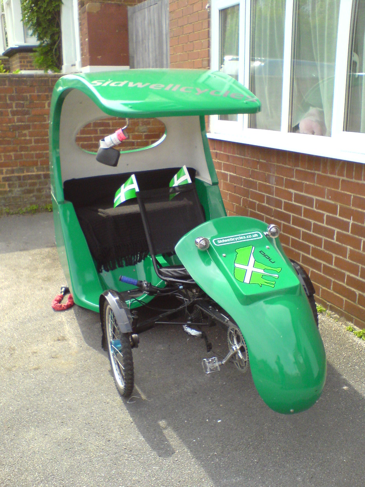

This thread appears to have digressed since it was first started but the original point was something I'm currently looking into now. I have looked briefly at how motors work and as I understand it a car alternator is very similar to a brushless DC motor. Correct me if I'm wrong but a BLDC works by applying a 3-phase high power signal and having a permanent magnet to generate the field. An alternator has an electromagnet field and 3-phase (output) which goes through a bridge / regulator to charge the battery. What's stopping someone disconnecting the bridge/regulator, applying a DC voltage to the field windings and a 3 phase signal to the 3-phase part, just like a BLDC motor?
I only ask because I have an alternator knocking around and am looking into powering a small electric bike / vehicle. Building most of it from scratch. I initially thought of getting a BLDC hub motor (from China) to get me started, then work on a controller to replace the one that comes with the hub.
See attached pic of the vehicle I am planning on motorising.
Any comments / recommendations?

Without even considering the torque. You would need 3 phase AC to run it. Yes, an alternator starts out a a 3 phase source and is rectified but you can't apply DC to a rectifier and get AC out. It just would not be at all practical to use an automotive alternator and modify it to push a bike. You would need three phase AC to run it and the shaft speed would be a function of the AC frequency.
I don't see any theoretical problem with that; just the practical problem of having to start with DC and invert it (with associated inefficiencies) to 3-phase AC and control that. So simpler (and even perhaps cheaper overall) to start with a BLDC motor.
I'm sorry if I wasn't clear, I know I would need an inverter to run it and not just a reverse rectifier. Just to clarify, how is a BLDC motor driven compared to how an alternator would be driven. It seems the same to me. Is it that driving an alternator is unknown and a BLDC motor already has a controller. If I plan to build the controller myself anyway? I was comparing an alternator to a 1kW 48V hub motor, I figure an alternator is about 1kW but is only 12V so would be 80Amps+ to run it whereas the 48V motor would be 20Amps which would be easier to control. Would it be possible use a BLDC controller to run an alternator or is it more trial and error?

Your 20A and 80A values presumably are assumed average values, so peak current is likely to be much (40%+?) more.
