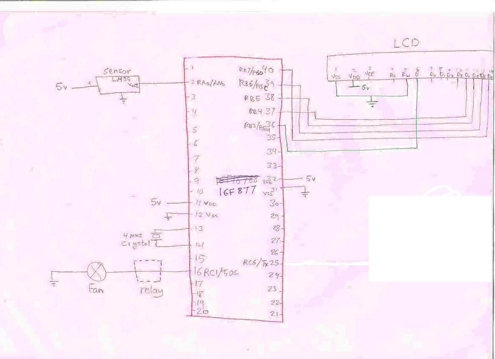

could any one help me . i have this circuit
and i want to do the PIC read the signal form the sensor and do compare like if the signal is 20 turn ON the Fan , and if the signal up 20 turn OFF the Fan and all this i want to shown in LCD. i have a code but does't work i know know why? if any one know what's wrong plz tell me. thank you very much
all the best
and i have a code or the program does't work i do't know.
thank you very much

iam sorry
it just circuit in the link
thank you very much

That circuit cannot work as it has the RS line on the LCD disconnected. Your code suggests it should be connected to PortB,2.
Have a read of the sticky and look at some of the tutorials.
You've also completely forgot about connecting MCLR also.
Good luck!
