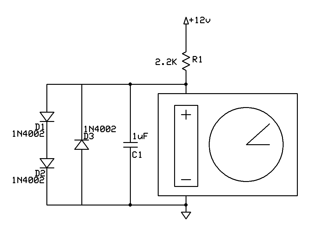

hi what's a cheap way to hack up a driving timer, something that will count how long i spend in my car per day, something i can reset each day.
i'm thinking that the timer should run when the ignition is on, and power is detected through the cigarette lighter.
by the way if you can think of a cheap 'hack' eg. using a small mechanic alarm clock im happy to look at these options and modifying the voltage input to use a 12v battery to trigger the timer, and maintain accuracy, im happy to consider these ideas too.

How about one of those cheap desk clocks that run off a 1.5v AA battery? Replace the battery with a voltage dropping circuit, and attach it to your ignition circuit. See attached. Just reset to 12:00 at the start of each day. Read the hours and minutes...and seconds...off at the end of the day.

the circuit you described is good for an output of 1.5v right ? does it matter if the input voltage changes, for example if the alternator changes the input to ~13v.
if the ignition is turned off (when leaving the car) doesnt the timer reset itself? I want the timer to be good until I reset it not until the car is turned off.

The circuit acts as a 1.5v output regulator. It will handle input voltages from 5v to 25v. The "timer" is just an analog desk clock...if you pull the battery, it stops where it is. If the circuit is hooked up to the ignition circuit that is 12v when the engine is running, and 0v when it isn't, the clock will start and stop with the engine. Set it for 12:00 in the morning, and if the engine runs for 3-1/2 hrs during the day, the clock will read 3:30.

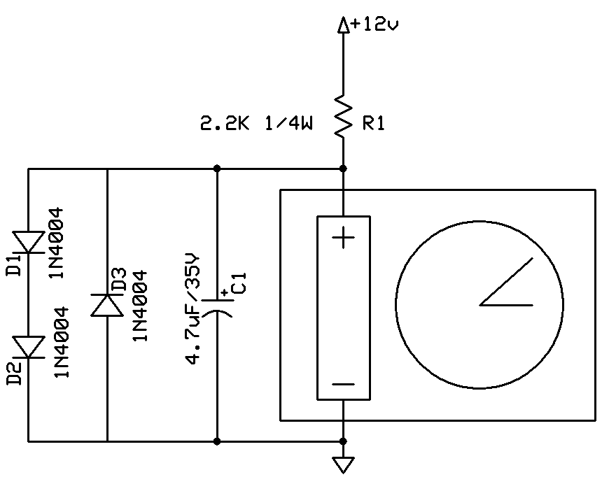

Now I just need a cheap clock and the parts which im guessing will only cost a few dollars. whats a cheap yet effective way to connect all the parts up, should I use a board?
Cheap source of clock: Goodwill, Salvation Army, Dollar Stores...
Diodes: Radio Shack 276-1103 (1N4004)
Resistor: Radio Shack 271-1325 (2.2K 1/4W)
Capacitor: Radio Shack 272-1024 (4.7uF/35v)
I substituted an easier to find capacitor, but note that this one is polarized and must be installed with correct orientation.
Modified schematic attached.
What I have done for mounting small regulator circuits, when using a cigarette lighter plugs is get one of the car-charger cords for cellphones, again from Goodwill, and gut it. Install my regulator inside it. Wire that to a dummy battery, to fit in the clock, made of a wood dowel and a couple of small screws.
