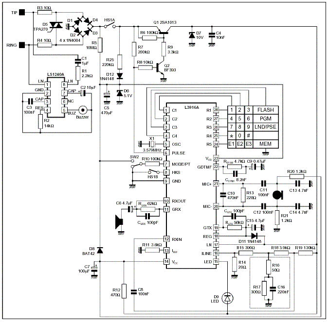

hello i am fairly new to electrontics but know the basics and i want to build a automatic phone dialer. i want use a ic but don't totaly understand them. i know for a fact i can use electric gates but i will need 80 gates for one phone # :shock: to do this which will be very exspensive and bulky. But the gates will allow me to program a phone# with just a key pad. so is this possable with a ic. O one more thing i really do not want to just go out and buy a Automatic phone dialer. i want to do this from scrach thanks

ok i searched for a site and found one www.winbond-usa.com/ i think the ic w9146xn is just what i want it has the pusle dialer and a 3 number memory. since i am using this for a alarm. so all i think i need is a keypad and mic and speaker and switch for on and off hook. I think this will work thanks.
ok i was looking over the datasheets and am alittle confused do i need to hook up a mhz crystal to pins 7,8 and what do pins 9,10,11,12,13 do. the defeniton of the pins function is to complacated for me to understand. however i do understand pin 1,2,3,4,5,6,14,15,16,17,and 18. thanks
All telecom IC use 3.579545MHz (NTSC color subcarrier freq...) quartz, just connect it to XT-pins.
9 - output for handset to muting the dial pulses in speaker
10 - this input detected the hookswitch state (need for redialig and sleep mode)
11 - dial pulse output can control a serial transistor with line for pulse-mode dialing (also need for flash-function)
12 - DTMF audio frequency output for tone dialing
13 - mode control by hardwiring (when this input is High (connect to Vdd), You can dialing in pulse mode, when Low (connect to Vss),only in DTMF.
See this application,this is another type with speech-circuit, but maybe a good startpoint....
