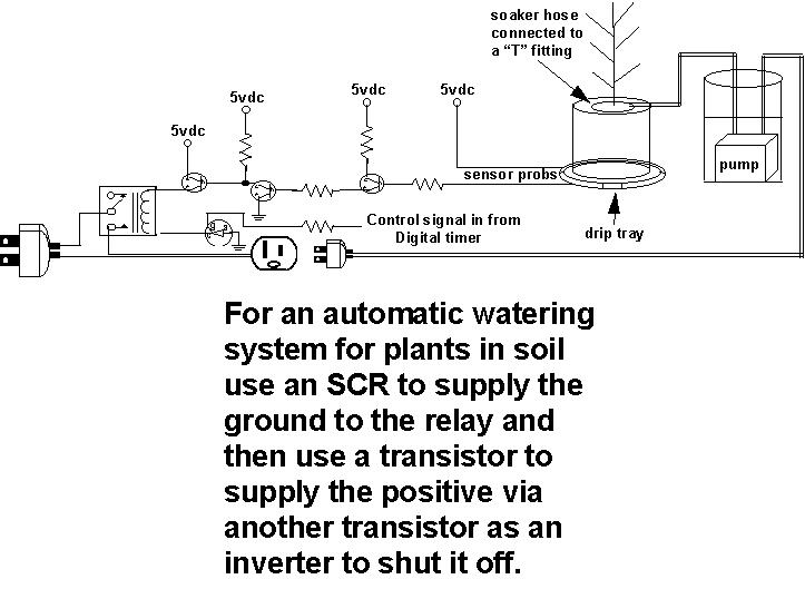

im designing an automatic plant waterier for a school project..but i cant seem to get the right electronic circuit!plz help!
it would have 2 prongs in the soil to check the dampness/dryness and when its recorded the soil is dry the circuits starts the water to water the soil. thats the plan anyway! thankyou kindly
