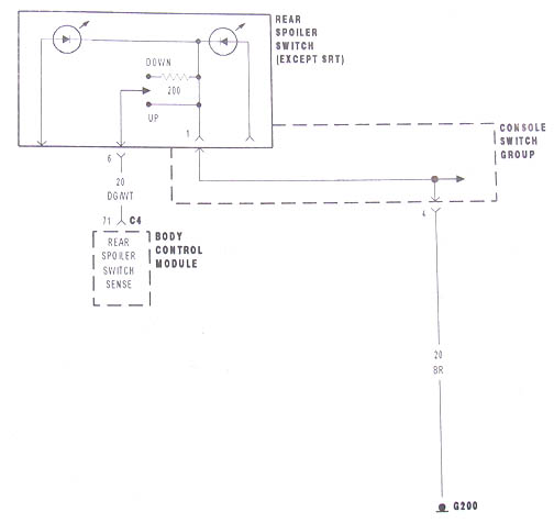

I admit I know nothing about electronics. But I'm looking for someone who is interested and feel's they could come up with a more elegant solution to my spoiler problem.
Chrysler Crossfire's (XF) Base and Limited cars (made by Mercedes Benz) all have electronic spoilers. The top of the line SRT-6 gets a static bulky Spoiler.
I just bought a XF SRT-6 which I'd like to switch out the spoilers. Apparently a fairly simple fix can be made to the spoiler to make it go up and back down by holding down on a SPDT switch for several seconds. What concerns me is in the service manual it talks about 5V. The 'simple fix' would have 12V going directly to the motor.
On the electronic spoilers they automatically raise at 62 mph and retract at 39 mph. There is a switch on the dash which will raise and lower the switch if going less than 63 mph.
I'd be happy if I could use an original spoiler dash switch which I'm told only sends signals (no heavy lifting, so to speak). My absolute ideal would be to have the spoiler function just as the Ltd/Base cars do. Along with a functional original dash switch that raises and lowers the spoiler.
I could live with just the switch providing it is an original one and goes up automatically, though it needs to be held down to lower.
I'm fully aware that this post is very arrogant but hopefully someone very knowledgeable in automotive electronics, would be willing to 'take this project on'. I have a complete spoiler and dash switch for starters.

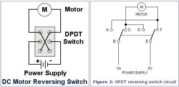

The DPDT switch on the dash is no problem. You need limit switches to stop the motors at the ends of their travel.
As for the 5 volts, post any wiring diagrams you have. Do you know how you are going to detect 62 MPH and 39 MPH? We can do that but we need more info.
Edited to replace a wrong switch wiring picture.
Recheck that drawing, that one will not work as both motor terminals are on the positive.

I share rodalco's opinion on the schematic, however the pictogram looks correct, at least on dpco switches I've used before.

Sorry guys. That drawing was wrong. I found a better one.

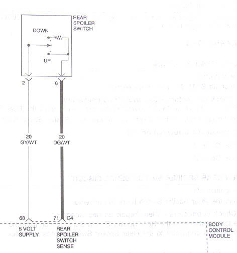

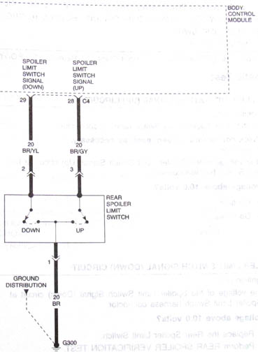

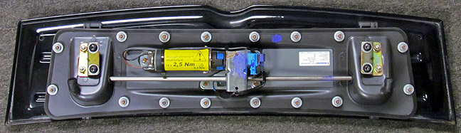

Wow! I really appreciate all of these replies. I have the 2007 Chrysler Crossfire service manuals (three volumes) which total five inches high of very thin paper. There are various locations for the spoiler information - none that I've found that even mention 62 mph up and 39 mph down. And I believe there is only one voltage given of 5 volts - most everything disappearing into the black hole of the BCM. I'd say that there are roughly 28 or so pages that the spoiler is mentioned or is the sole item on the page. Regarding the limit switch it says, "Rear Limit Switch - Rear of Vehicle." Pretty helpful, eh? I assume that it is located in the PTC which is in the trunk floor. Unfortunately my scanner, which is two inches from the computer, can not be located. So I'll use my digital camera and send a few photos. Regarding the underside of the loose spoiler you'll notice it is quite small - 29 inches wide. The yellow item is the motor, to the right is the gear-box. I do want to point out that even though I'm sending information regarding the BCM, I'm quite sure this 'project' has to be a completely separate unit. IF it could be made small enough to fit on/in the area next to the gear-box that would be very helpful. I have no idea if the images I've included are helpful or not. Titles of diagrams: A - Rear Spoiler Inoperative; B - Rear Spoiler Switch Sense Circuit; C - Spoiler Limit Switch Failure; D - Spoiler Switch Led Circuit Short To Voltage (the latter asks if the voltage is above 5 volts).

If that is the whole unit, it looks like it doesn't move very far.
Do either one of those labels say what voltage the motor is?
Are limit switches part of that assembly?
Does it look like there are any circuit boards on it or just motor, wires & switches?

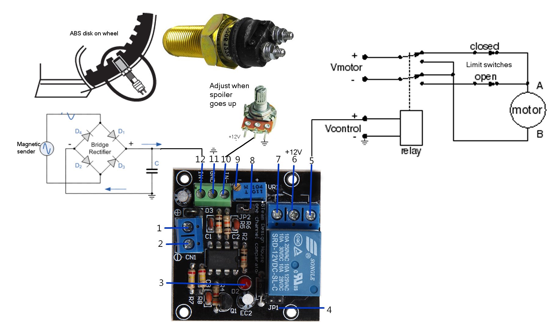

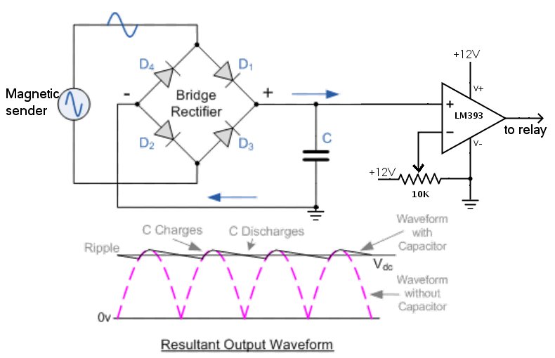

A Yanmar magnetic tach sender is mounted close to the teeth on the flywheel ring gear. It puts out an AC voltage that increases with speed. At high RPM, I think it was 18 volts.
If your car has anti-lock breaks, there is a disk on each wheel that looks like a gear. If you mount a magnetic tach sender close to the teeth on that gear you will get a AC voltage that increases with speed. If you make it DC with a rectifier and smooth it with a capacitor, a comparator can turn on when your signal matches a reference voltage. BUT, the signal can't go above your 12 volt supply voltage. That ABS disk won't pulse as fast as a flywheel but you need to test it.

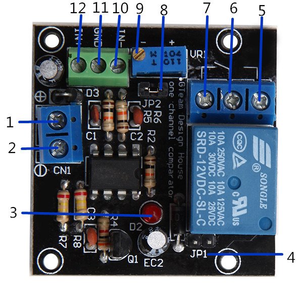

If when reducing your speed, the spoiler retracts before you want it to, then you will need a "window" comparator.
This little module will make things easier for you.
DC 12V 30MA 1 Channel Voltage Comparator Module LM393N LM339 IC Chip
Function:
1. Enter a voltage and the reference voltage contrast on the module (The reference voltage can be set by an adjustable electrical overcast), When the input voltage is greater than the reference voltage, Relay closed. When the input voltage is less than the reference voltage, Relay does not operate
2. Respectively inputted two special Compare Voltage signal 10 and 12, When the voltage signal 12 is greater than voltage signal 10, Relay closed. When the voltage signal 12 is less than voltage signal 10, Relay does not operate
3. Enter a voltage and the reference voltage contrast on the module (The reference voltage can be set by an adjustable electrical overcast),When the input voltage is less than the reference voltage, Relay closed. When the input voltage is greater than the reference voltage, Relay does not operate (opposite with function 1)
The reference voltage: The reference voltage of the module is the input voltage obtained through precision resistor divider, It determines the range of input voltage reference voltage, For example, the input voltage is 12V, then the reference voltage can be set in the range of 0-12V.
Operating voltage: DC12V
When the comparator energizes the DPDT relay the motor raises the spoiler until the up limit switch opens, stopping the motor.
When the comparator de-energizes the DPDT relay the motor lowers the spoiler until the down limit switch opens, stopping the motor.

The pics don;t tell us much, Likely there are 5 wires. 2 for the motor and 3 for the switches and the switches are mechanical. You do need to determine how the switches are wired and if they are open or closed at each limit. So, the connector wiring would help. Two SPDT switches would be ideal.
The BCM sees logic inputs or low current inputs. The BCM COULD do independent over current protection if the limit switch failed. There could be a PTC mounted on the motor for failure protection as well.
This is very similar to the "chicken coop door" problem. In this case two SPDT relays are wired such that the C terminals are connected to the motor and the NC terminals are nals to pass.connected to ground. This effectively grounds the motor when the relays are off. The NO contacts go to +12. This gives you one relay that controls UP and one for DOWN.
The limit switches directly allow the UP/DOWN signals to pass. We can convert the commoned limits to activate a tiny 12 V relay to re-create the independent SPDT contacts.
So, it could be as simple as 4 relays, 4 diodes and a switch. If you were doing multiple ones or wanted to miniaturize it with more protection, you could use an H-bridge IC and some logic.

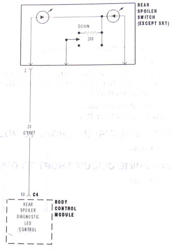

Info you need to find out:
Diagram C:
I can;t tell what the switches do at each extreme. Do they open or close at the extreme?
Diagram A
1. What's the value of the resistor?
2. I assume that this is the switch you want to use?
3. Is the switch momentary? Both positions?
4. How long does it take for the spoiler to move from one extreme to the other approximately?
So, what I see is it's easy to do with an UP/DOWN switch.
Harder to do if the switch in diagram A is two position.
Harder yet to do if the positions are momentary.
Automatic is harder yet.
