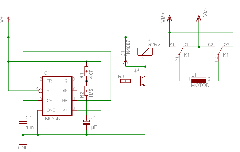

I assume you have a simple DC motor.
A capacitor cannot change the direction of a motor. At best, it can filter brush noise.
To change motor direction, you must change the polarity of the DC voltage going to the motor. This is done by swapping the motor's terminals against the supply voltage. An H-bridge composed of 4 transistors, or a DPDT relay will do the job.
what I think he is talking abt is using a cap is say a 555 timer circuit such that after x seconds this chip changes its output from LO to HI,
This logic signal can then be passed to the H-Bridge power-circuit to change the motor's direction
yep that would work fine, have a search for H-bridge and 555 timer circuits. a bit of "glue" logic and you have your motor revering circuit

To make it reverse by itself you could build a 555 timer circuit (lots of scematics if you google). calculate the 555 setup for a 0.5Hz frequency and a 50% duty cycle (that would make the output high for 1 sec, low for 1 sec, and so on...).
This output could then be fed to your H-bridge. if you use the L6203 bridge the 555 output would be connected directly to IN1 and to IN2 trough an inverter.
You could then use a normal switch to have a on/off function for the entire setup

The simplest way is to use a latching DPDT relay and 555 timer- ever y time the 555 fires the relay changes state. The next simple way , if you can't find a latching relay is to use an ultra sensitive relay with a cap across the coil ( 100uF or so ) to ground you can get delays of a few seconds this way and when the charge on the cap drains the relay automatically opens and changes state .The constraints would be that the r/c timing constant on the 555 is equal to >2x the amount of time the cap allows the relay to stay on. The 555 fires and activates the relay . The machine goes in one direction. The charge dissipates and the machine changes direction it goes back to the original position and the 555 fires again. Trick is you don't want the 555 to fire too soon or to late. Too soon and the machine will gradually go forward too late the machine will go gradually back-wards.

A relay would also be better suited for the high currents caused by instand reversing (without braking first)

how will I hook up the 555 relay to the other components??? can someone draw a schmatic diagram?
also, are any of the components (relay) on this page? https://www.radioshack.com/category.asp?catalog_name=CTLG&category_name=CTLG_011_002_013_000&Page=1
thank you
555- values are calculated for 50% duty cycle and about 0.5Hz
