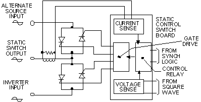

does anybody know where I can find any schematic about an Automatic transfer switch? or some information that can help me? because I am trying at a long time to build one, but I don't have any idea, I would like to do something using a pic microcontroller.
it would be something as in the diagram below..
Regards
Elson

You need to specify the speed of the switch and current capability. Most industrial level transfer switches can do it within a 1/4 of a cycle during an interruption. The speed factor will greatly affect the complexity of the switches etc. When interrupting a large current, huge spikes can be generated which wreak havoc on logic and the SCRs or other switching devices.
I don't have any info on the circuit of the transfer switch but I'm sure it will be very complex.
I did tested many and they all have several circuit boards the size of A4 paper connected together with ribbon cables. So I believe the schematic diagram would be running into many pages long.
This is how I tested them. I connected an UV oscillograph(an recorder that draw traces using UV light on UV sensitive paper roll) to the transfer switch output, started it running and then I switch off the normal source so the switch transfer to the alternative source. Waited a bit and switch the normal source back on and watch the transfer switch did the transfer yet again.
There should not be any discontinuity in the output sine waveform, like nothing had happened, not even a spike. Otherwise, why use such a switch when a simple relay will do the job. The transfer switch was part of an inverter rated at 110V and 200A full load.

I've not really read up on this but here's my theory on how big UPSs work.
The inverter is continiously running but off load so it doesn't draw much current and it's also in phase with the AC supply. When the power fails the inverter just takes the load but is disconnected from the mains to stop it from trying to power everything else on the same phase. When the mains power is restored it's simply connected to the mains again. The only difficult part is detecting whether the inverter is powering the load or the mains is, but this can be achieved using a current sensing transformer/resistor.
there are 3 poles, 1 neutral i'd assume.
I seriously wouldnt suggest you building your own automatic switch, the relay part is easy, but the contact part is not. arc flash can go up to 30,000 degrees and it can vaperize copper bars. and when you can not keep them inphase your engine will shaft.
