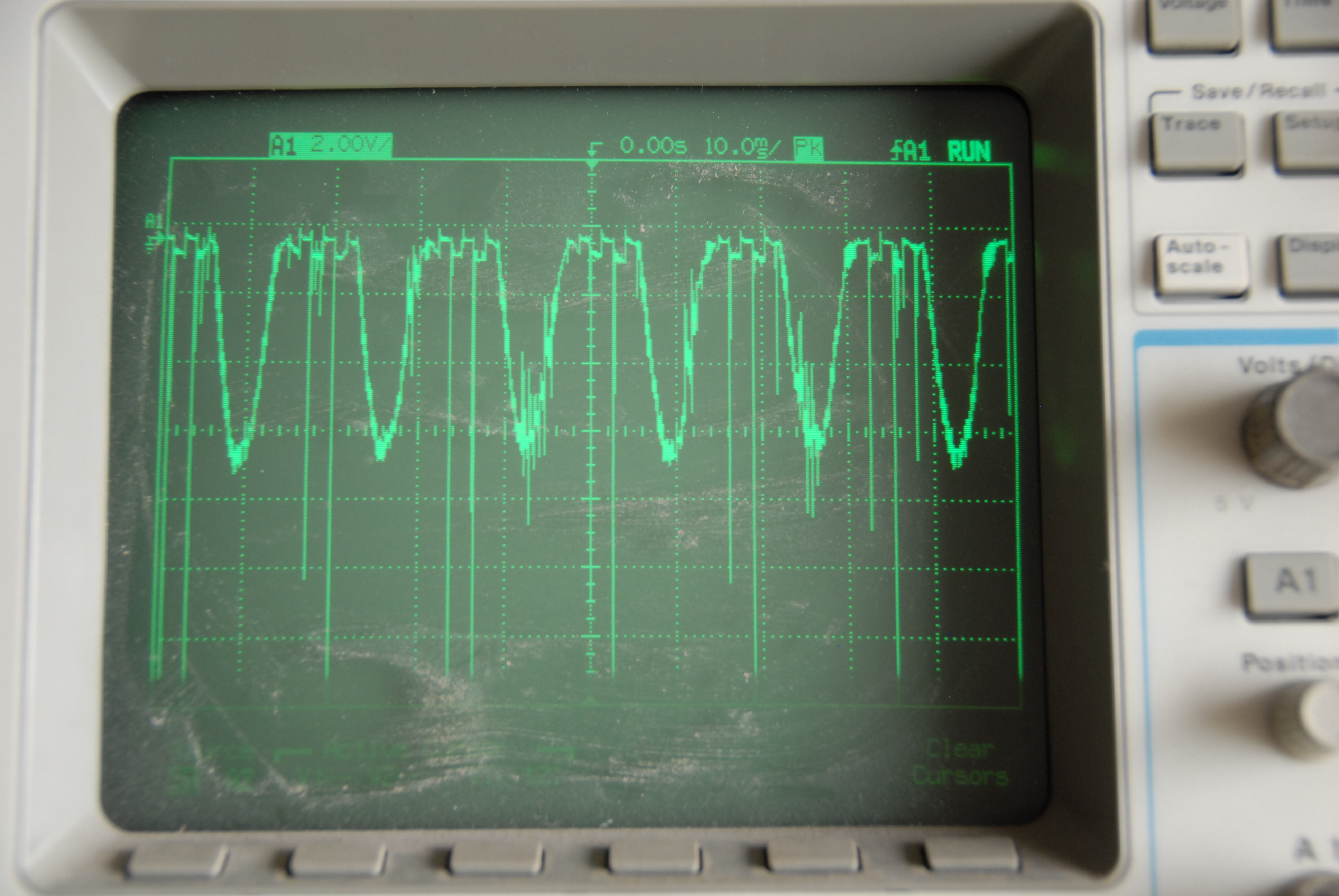

Thank you all very much for your input. I greatly appreciate. I have some screenshots of a voltage signal. This is not mine. I am replicating what someone else did and this is their screenshot. Basically, I am using a gated pulse that will go to a transformer. This is a screenshot of the primary.
I would like to build a circuit that will take this voltage waveform and "compute" the average voltage of this waveform. The output of the circuit will be a DC voltage that is the average voltage of the waveform. I am going to have 4 of these circuits and I am unable to take ADC readings during the pulsing of the transformer. Simply because I will not get enough resolution.
The RC filter looks feasible but I am concerned that it will simply smooth out the waveform and I am not going to get DC. Please correct me if I am mistaken.

Where is the 0V level on that waveform? The RC integrator will give you the average of the waveform including any DC component. But if it has a negative component then that will subtract from the positive (giving a true average). If you want any negative portion of the signal to be included in the positive average then you will need to rectify the signal with a precision rectifier before averaging.
The LPF will smooth out the fluctuations and you will get a varying DC value which is proportional to the average of the wiggly signal.
How much that DC value varies will depend on the time constant of the LPF compared with the lowest frequency in the signal.
