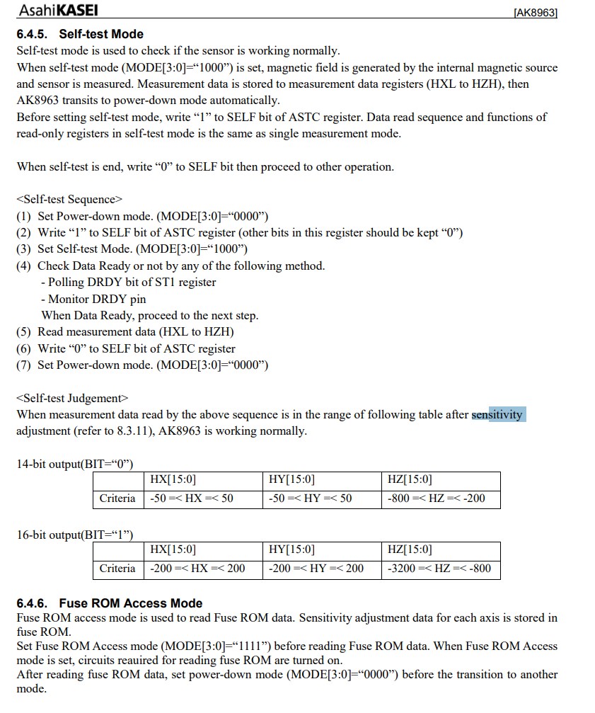

My thoughts are: that if I'm correct, then the 255 READings show a negative BYTE. If I note this, can I average the LB, noting whether it's HB is 0 or 255, and act accordingly, whatever that is?
EDIT: Sensitivity change Image added

I don't think so.
If the high byte is zero, then it is ok.
The average must be a word, because summing the values may exceed 255.
When the high byte changes between 0 and 255 you have anyway to make the 2's complement conversion.
The Y values seems to be faulty, if the compass was in the same position between the readings.
They change between about 0, 98 and 255,112
or 98 and -144 in decimal.

You don't 2's complement the bytes, but the word they belong to ( high byte, low byte)
