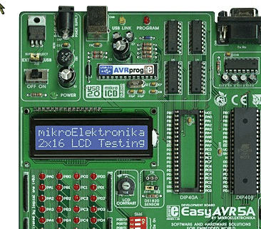

I will be using the LCD that is present in the AVR kit, i dont really know what kind it is.
The AVR kit had ADC, oscillator, LCD, LED etc so i have to use that, its an 8 bit avr kit from micro electronics.

OK i think thats clear now.
Look into the help topics of your compiler.
There should be found LCD FUNCTIONS.
A short "C" description
You have to include the according LCD include file.
#include <lcd???.h>
In most compilers must be defined the connection / port between the AVR an the LCD
#define LDCDATA4 PORTB.4
#define LCDDATA5 PORTB....
The next step is to init the LCD in the main routine
lcd_init();
Now you can use the LCD Functions.
lcd_gotoxy(0,2);
lcd_putsf("Text");
The includes, comands and definitions can vary of this "C" description.
It depends of the included LCD file.
The right ones could be found in the help topics of your compiler / include file.
When you'll using assembler, you can search for an display routine in the internet.
AVR Studio ( assembler ) has no LCD routines included.
HD44780 Hitachi Controller
Hi Eric,
Thanks, it is the hitachi controller HD44780 and it is exactly what i have to use...
Wkrug,
Thanks for your help, i will try out what you have told me...
