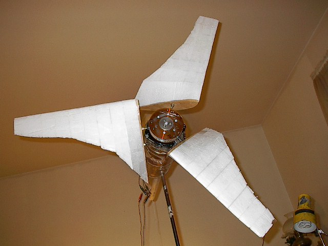

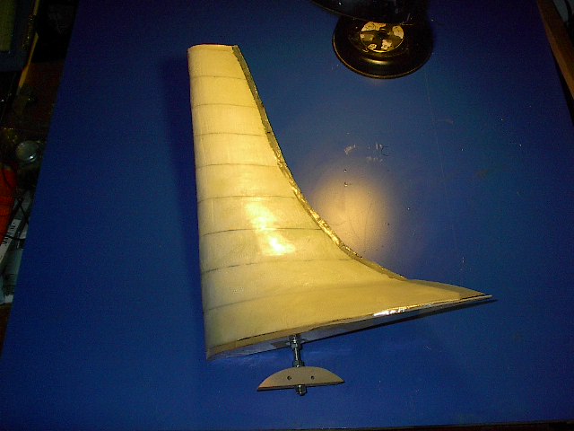

since i have been working on my own fiberglass over foam blades i have a lot of opinions on them.
figure about 98 rpm in a 7mph wind for your blades
are they still on paper or have you built them cuz that is a lot of work in itself, a lot of work.
recently i've been working on a way to test them , and for that i need instantaneous wind speed and torque measurements
without seeing your blades i cant form an opinion other than what the rpm may be at a certain wind speed.
the first photo is a completed epoxy-glass over foam blade , they are 3.5feet in dia.
the second photo is a shot of the 3.5 foot blades - no glass
