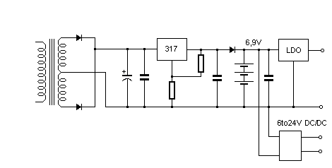

I need your help to build a power supply working on 230VAC mains with a battery of 6V/4Ah alkaline type for supplying the power in case mains fail. The output should be 5V/750mA and 24V/100mA , both regulated and DC and Isolated. The circuit should be capable of charging the battery as fast as possible when the mains supply is on AND free from noise as well !!

3. The circuit should provide output till the battery voltage drops down till 4V. How this is possible ? Plz note that in order to charge the battery I can increase voltage above 7.6VDC( Best charging voltage I believe for this battery).
What I have in mind is converting mains 230VAC to 7.6VDC output of LM317 -TO3 pack. Using this volatage to charge the battery and also the convert this DC voltage to 22VAC & 6VAC ( appx) using a transformer for isolation purpose ( Xformer say 4-0-4 Input , 0-22 & 0-6 isolated outputs). Then on the output side of transformer using the type of regulator u r talking about.
In brief this is DC-DC converter with Isolated Outputs with Battery for uninterrupted power supply. (UPS if I am not wrong )
I hope u got this. Or should I post a block diagram ?!

The maintanence-free lead-acid batteries designed for continous charge mode. You must keep the voltage on 6,9V.
Do You thinking about circuit like this?

This will not work if the battery voltage falls to 4V. Isn't it? For this we have to include both boost/buck arrangement !!
Secondly grounds of 5V & 24V are not isolated. I will be using 24V for field sensors which may be prone to noise due to lot of cable connections.
Hence the need of transformer in between.
LDO !! Hmmm . Well I would prefer to stick to cheap LM78XX series as LDOs are generally costly. And will it source 750mA ? I am not sure

For 6V lead-acid battery the 4V deep-discharge is end of life.I recommend the discarge about 5,4...5,3V, so the LDO can work in 5V section.(this is cheaper as boost regulator). The 24V is floating, because the quad with four legs symbolize a DC-DC isolated converter. I mean, no cheaper solution with Your parameters...
