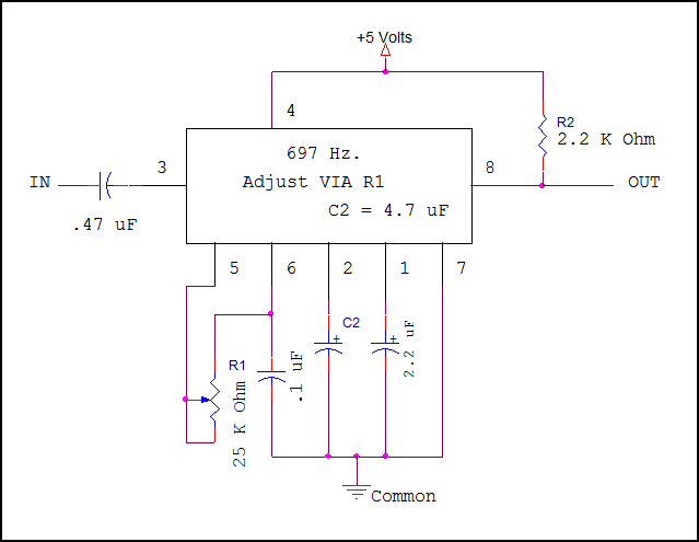

OK, let's try this. Attached is a basic configuration using the 567 as a tone decoder. You should see that it bears a resemblance to the one circuit i the data sheet.
The 567 contains a PLL (Phase Locked Loop). Pin 8 of the chip will go low when the input frequency matches the chips center frequency. That center frequency is set by a few external components. The timing resistor and capacitor (R and C)and is (1.1) / (RC). You want the value of R between 2K and 20K for best results. The chip will work with frequencies between .01 and 500 KHz. However, with very low frequencies the chip will take longer to detect the incoming frequency.
In the attached cartoon the timing resistor tied to pin 5 is a variable 25K Ohm resistor. Using a variable resistor allows tuning the 567 to a range of frequencies. In this case the .47 uF input capacitor would tie to the (+) of your speaker lines and common would be common (tied to speaker common).
The parts used in the 555 circuit have nothing to do with the 567 circuit. The purpose of the 555 is simply to be an oscillator source so just a frequency source. The source doesn't have to be a 555 as it can be anything. I mentioned use of a push button tone module from an old telephone earlier. Just think of the 555 as no more than a source. Therefore there is nothing in common about the 555 or 567. All you want is the 555 to be an astable oscillator circuit.
If for example you built an oscillator using the 555 that ran at 1 KHz then you would choose your R & C in the 567 circuit to respond to 1 KHz. If you use a variable timing resistor with the 567 (as I did) you would then output the 555 to the 567 and tune the 567 (using the variable resistor) till pin 8 of the 567 dipped low.
Does that help?
