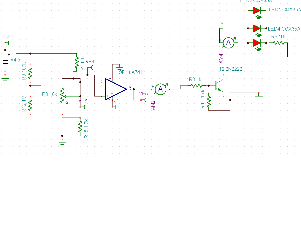

I thought I had it working BUT changing the pot (voltage on Port A.0 ADC) seems to slow down the PWM code but can't get it to stop the PWM (LED candles go out in LIGHT and code enables the LEDs on B ports when A.0 is dark

going with a 741 op amp compatator
hopefully this circuit will work.
It should??
R12 is a photo transistor aprox 150k in light and 1Meg in dark
