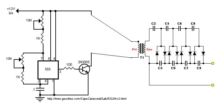

Back EMF blowing 555ic. How to stop it??
Do you have an oscilloscope?
It would be interesting to observe the voltage waveform at the collector of the NPN transistor.
You are probably getting a voltage spike at this point, which drives a reverse current back through the IC ..... through leads 4 or 8.
Try putting a diode in series with the ignition coil... between the + supply and the ignition coil .... The diode specification should handle several amps ... and have a sufficient voltage operating level so that it is not damaged.
... not taking any responsibility for additional damaged ICs .... just a guess at this point.

I allready added the diode but problems still occur. Instead of the igniton coil im using a transformer (not that it matters alot because they are pretty much the same thing).
The transformer puts out about 400-500ish volts AC which i have then put through a series of voltage multipliers which changes it to about 4Kv DC. This is where the sparks occur.

Can you post your circuit, showing any decoupling you have on the pcb.?
attached is the schematic, pretty obvious what it is.

If you can find a capacitor ... something like 400V rating ....1 uF .... try placing this between the NPN collector and circuit ground.
The idea is to ground out some of the higher frequency components of the voltage spike that occurs when the transistor is turned off.
....not absolutely sure about the specifications or value necessary for the cap ... you will just have to try something and see if there is any improvement.

If you use an IRFP460 with a 1N4004 or higher voltage (1N4007) connected between source and drain you won't have back EMF on the timer circuit. Use 470Ω for a gate resistor.
Secondly, you can generate high voltage (20 to 35KV) using an ignition coil (made for electronic ignition systens with a resistance of the primary winding of 0.7Ω) with it's primary winding connected to terminal 1 of the ignition coil and the drain and terminal 15 connected to +12V.
Why bother with a selfmade HV transformer which might spark inside without you knowing it caused by one twisted (and uninsulated) turn already?
Give the ignition coil a break every once in a while using short pulses (duty cycle 30% or less) to prevent overheating. Using 1KHz clock frequency corresponds to a 6-cylinder engine running at 20,000 rpm.

This exact question has already been answered recently, it's essential to power the 555 circuit and the coil independently, running separate wires back to the battery.

A clamping resistor across the transformer primary should do the trick. But that will affect the output voltage.

You need to put a good electrolytic cap right at the 555 power pin 8 to ground. I also recommend using a small series resistor like 51 Ohms in series with the IC power pins (4 and 8) and a 14V Zener diode from pin 8 to ground to protect the IC from spikes.
