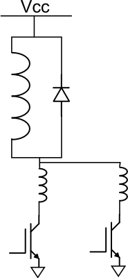

I intend on making a PWM controller for various applications. Occasionally, this may include switching inductive loads, DC motors are a definate possibility. What would be the way to fully protect the 100v max rated MOSFETs (35v max circuit voltage) in the output stage shown (they would be more than 2 in parallel, but I doubt it makes any difference anyhow).

'FULLY' protected is a very loaded term, but (obviously) the first essential is a reverse protection diode across the motor.

Just to re-itterate what Nigel stated, the free-wheel diode. Without it the FET will blow up very quickly (see drawing).
Now just do debunk yr "but I doubt it makes any difference anyhow"
Paralleling up makes alot of difference!!!
Again please see my diagram, yes it is using an IGBT symbol but same principle.
You see the small inductors at both collectors, this is stray inductance due to layout. it is alweays there no matter how good you think the design is. I use nice big laminant buzzbar made out of faily thick copper and I still get overshoots (this being a professionally made bar).
YOU must minimise this as much as possible, even sacrificing other parts (ie cost ie bigger heatsink) if needs be. The more you put in parallel the higher the chance of you not getting all of the FET's right up close to the diode, if they are not close there will be stray inductance and this inductance will produce a voltage overshoot at turn-off
To give you an idea I have been switching today an IGBT at 600A with a link of 350V my overshoot was reaching 900V and that was with a good bussbar!!!
Also I have said it umteen times before but I will say again, Gate-drive!
You are switching AMP's !!! DO NOT just hook up the gate of the FET's to any old voltage source, the switching behaviour of FET's starts to become "funky" w.r.t. signal switch characteristics when switching of current is involved.
You need to ensure you can drive the FET hard (say with around 1A of gate current) at a high enough voltage to keep it hard-ON

Ok, thanks for the responses. I have the gate driving base covered as i'm using smaller MOSFETs as drivers. I have the system on breadboard and using a 4 amp heater (and only one fet) it seems to work well, showing fast switching times, full rail to ground switching and the MOSFET staying nice and cool with a very small heatsink. But then the heater has no inductance issues. I have used a 1A DC motor with it, and although it works properly, there are lots of spikes showing up on the scope. Seeing as how I intend to use 4 IRF540, with a load of 20A hopefully possible, max voltage only 35v and plan on heatsinking to the case, is there any other way to protect the MOSFETs from inductive loads? Can diodes be placed around the FET somehow to protect it, 36v zeners?

You could use a Zener, but you will just cook it (dont under estimate the power of the backEMF :D)
Three options
1) propper power-cct layout taking into concideration.
This should be your main driving force! keep all hte power-components close (but not so close that arcing is a possibilty - you are working at low-voltage so not really an issue). DO NOT just use some leads to connect up, if you can make a busbar, you say you want 20A you are going to start to have some REAL problems if your power cct is not layed out to minimise stray inductance.
2) slow down yr switching!!! you will be seeing spikes when switching an inductive load due to turn-off voltage overshoot as stary inductance try's to keep the current flowing through them flowing. By slowing down the speed that the FET turns-off (normally by having a different turn-OFF gate resistor) it allows the strays to dissipate their stored energy by the time the millar-region has been reached.
This however, results in more losses (increased switching losses) in the FET
#1 is by far the prefered option BUT even the best layout will still have stray inductance in very bad places, this is where #2 comes in to "tune" the switching characteristics of the switch's to match the present implementation
now we get onto #3
3) Snubbers!! There was a time when these were needed for forced-commutated devices (1st generation IGBT's) but that time has now gone with 4th being fantastic, Snubbers are still used main due to extreamly poor power-layout resulting in either too much switching-loss or too high of a voltage overshoot.
a snubber's job is basically to shift some of the switching losses from the switch to the snubber dissipating element.
in its simplest form a snubber is a RC in parallel with the FET/IGBT and get more elaborate
#1 with #2 is by far the best way
If you are going to parallel a few FET's, often a series gate resistor of say 10 Ohms is often a good idea. It helps with spurious oscillations during switching. Miller effect can cause problems during fast switching, which can get complicated when paralleling FET's if they don't all share the load fairly evenly.

Paralleling FET's is fairly straight-forward as long as you stick to some basic rules, such as keeping all the gate traces as similar as possible, provide solid drive, and maybe some gate resistors.
I do it all the time at work, using ST's OmniFet, VNP49N04, a logic level TO-220 device. The FET's are mounted back to back on opposite sides of a vertical heatsink, in sets of 4. I use a 10 Ohm gate resistor. This particular FET is pretty indestructable, see the datasheet:
