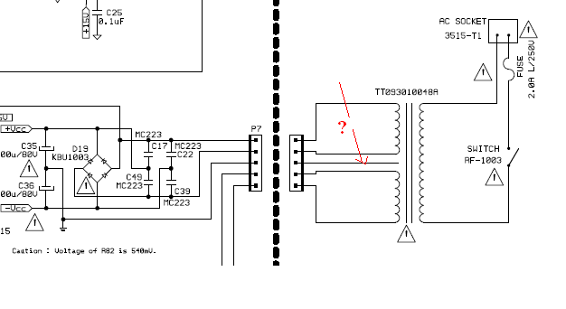

the transformer shown at sch in post #3 is funny in configuration.
the bridge (each of them) appear as full wave.
the trafo doesn't appear to have center tap. the wire leading to ground is shown floating inside the trafo location.The concerned sec is appended.
can I suspect a print mistake or error due to compression?
At times we have condenser blocked dual supplies. but cant take much load.
