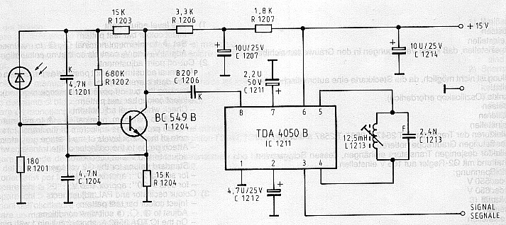

I don't know if this will help or not, but it's the circuit of the IR preamp used in some old Grundig TV's - Grundig were one of the last major manufacturers to change to the I/C preamps - due to the large quantities and reliability of supply they required.
I don't have any info on the chip used, but it's interesting they use an extra amplifier in front of it - a BC549 is a high gain, low noise transistor, used in microphone preamps etc.

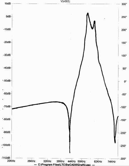

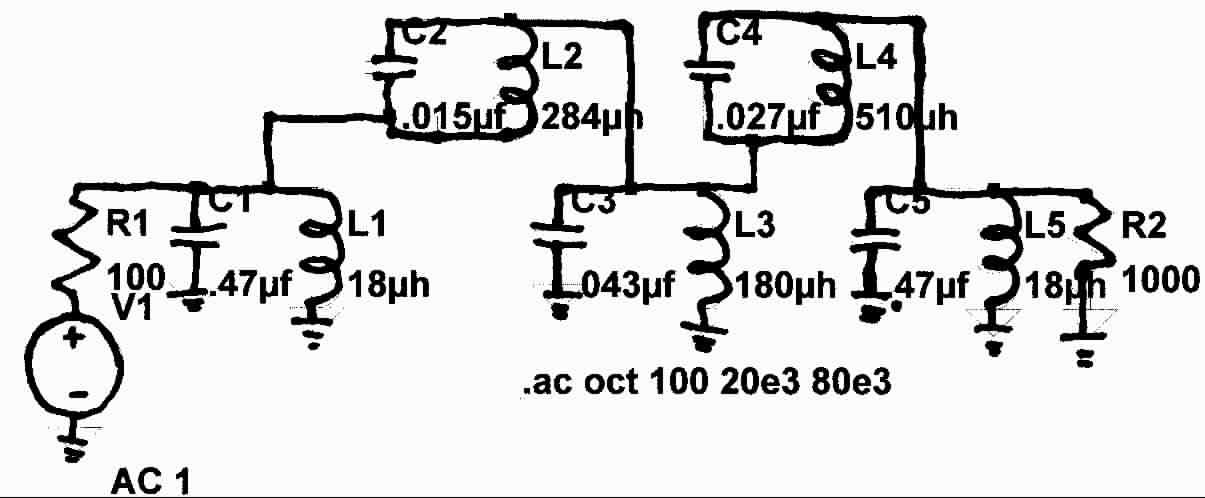

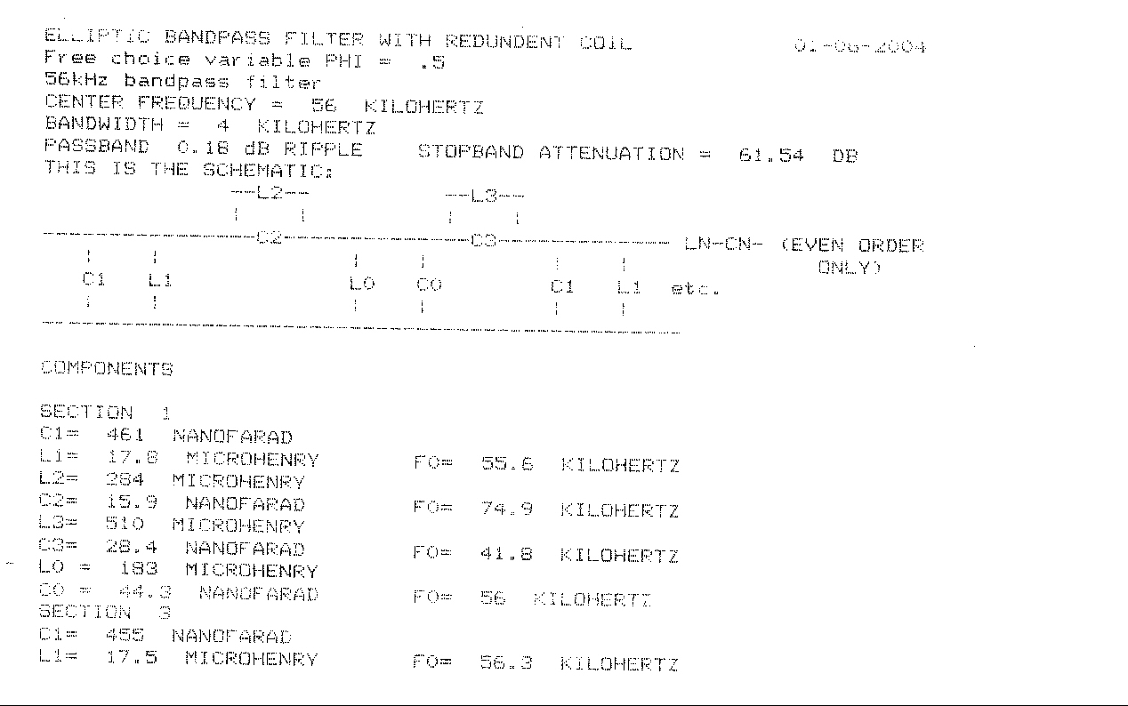

If you want to use an L-C filter, this one is quite sharp. I used standard values in the simulation, instead of the exact calculated ones, so the response has two peaks. I think if you trim it, it will have a flat top. The 100 ohm input resistance would be inseries with the driving op amp output, the 1000 ohm load would be in series with the input to an inverting op amp. The design is included in case you want to trim.
