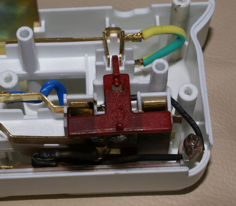

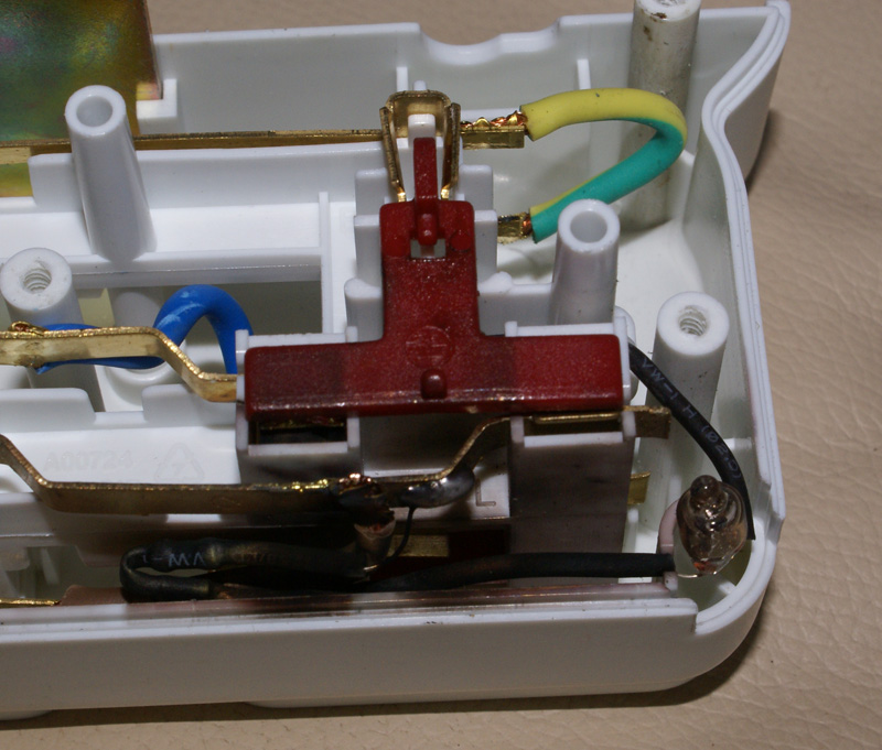

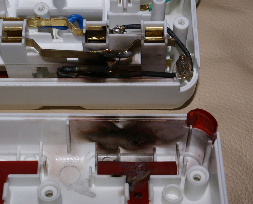

So I opened up the 6-way adaptor. The photos speak for themselves, really.
What I think has happened is that the live bus is quite close to the neutral one. The shutter is the red bit that stops anything contacting the live and neutral connectors unless something if first pushed into the earth socket. The shutter slides from the neutral socket to right over the live bus. Some debris, a strand of flex left over from manufacture maybe, got dragged from the neutral to the live bus.
The two photos wth the red bit shown over the connectors are with it in its open and closed positions.
So there was nothing wrong with the camcorder power supply that hadn't been used in years. It just happened to be the thing that I plugged in the time the 6-way adaptor, that is in use all the time, shorted.

I've just had another fault like this. A very similar short, which blew the 32 A circuit breaker / ELCB. There is a significant flash mark near the neutral connector, and a mark on the live bus-bar that is just above that. The shutter would have moved from the neutral connector away from the live bus-bar, so I can't see how anything got to the bus-bar. However, there are various bit of conductive debris which could have caused it.
Just looking at your pics from 6 years ago (time flies when you are enjoying yourself!), I don't see that the strips actually touched each other.
Either there was some other conductive debris in the extension block, or the shutter has rubbed on the busbar and built up a thin film of conducting material which has vapourised and made a momentary short circuit between line and neutral.
Weird.
Weird.
I came to that conclusion as well. In the recent case there were similar marks on the neutral socket and the live busbar.
I think that the busbars should be away from the movement range of the shutters, or insulated. On both of these the plastic shutter is very close or touching both the socket and the other busbar. Obviously the shutter doesn't normally conduct, but it seems that can change.
