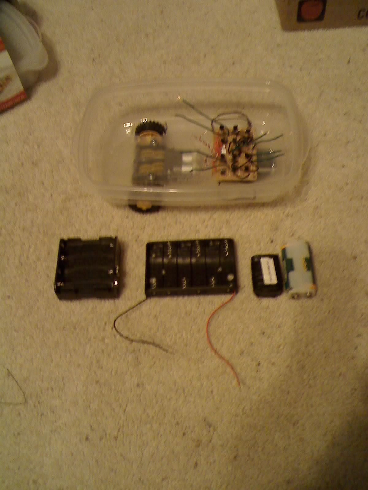

When I build robots, each one usually has a special design made out of Aluminum flashing (Spaghetti, Phobug) Cardboard (Fusilli) or everybody's favorite, Tupperware (fettuccine). But now that the robots become more complex, I need a more universal way of building my robot bodies so that I don't have to spend a bunch of time making a new body for the robot. I could just swap in the new control board and I would already be ready to go, no hassle. That is why I came up with Rflex1. Rflex1 is a Robot body that is ready to go, all you have to do is plug in the power and H bridge controls, and you are ready to go! (Pic1)
Rflex1 Stands for Robot Flexible 1. Meaning that I could easily adapt this body to other uses, say if I had to drill a hole, I could easily do that. Then once I have the entire robot completely made up, It would be in modules, making it easy to swap them in. A entire robot name would be (light seeking module) Lightflex1, which results in really cool names! Then when you come out with a better Light Seeking Module, you would call it Lightflex2! So much fun :D

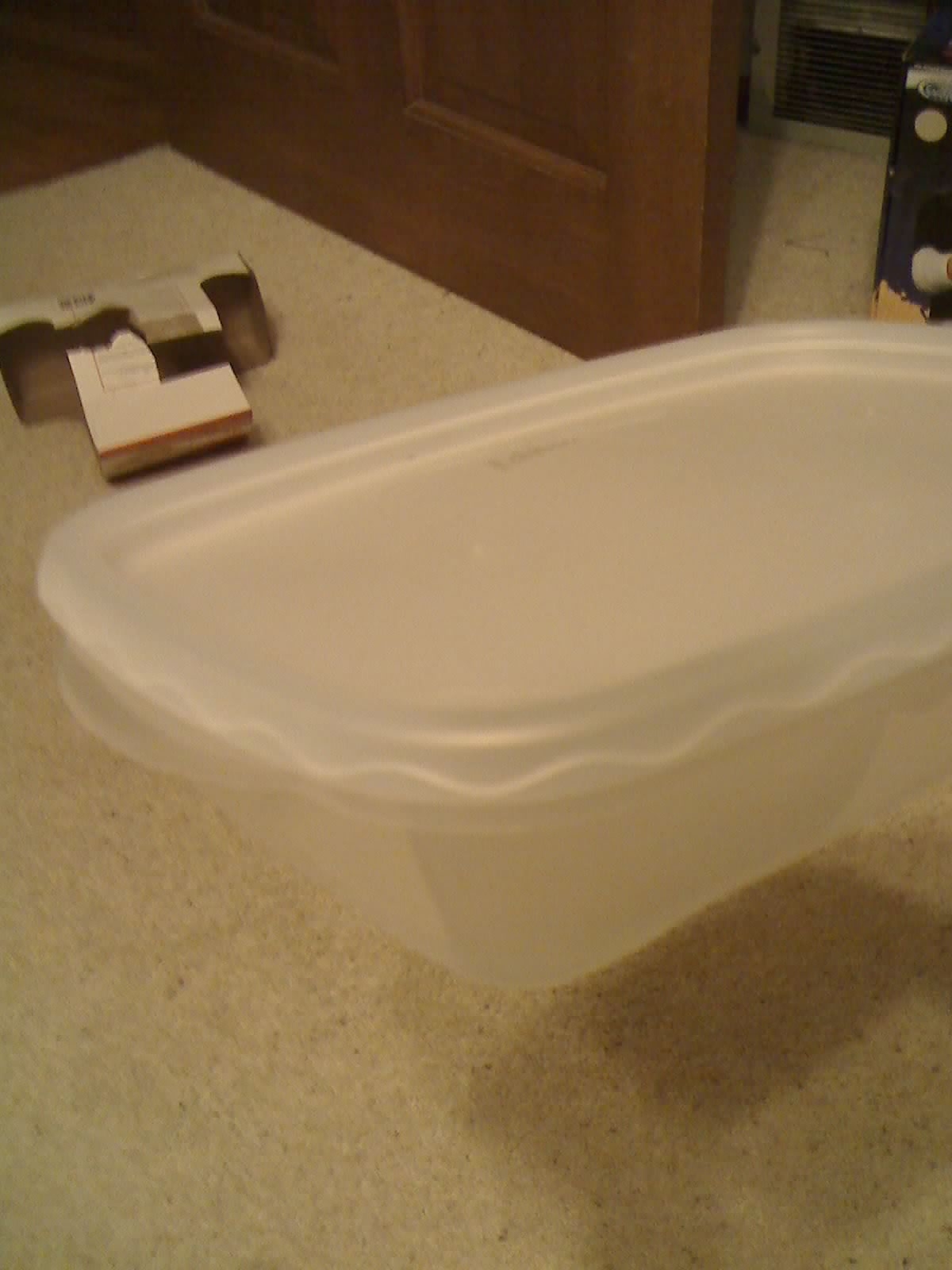

The Rflex1 Body consists of a RUbbermaid "TakeAlongs" Tupperware at 4 cups. This makes for a large body ready to go. The pack that I got was only 3 dollars (at Meijer) and comes with 3 of them, perfect if you accidentally mess up. (Pic 2)(Pic 3)

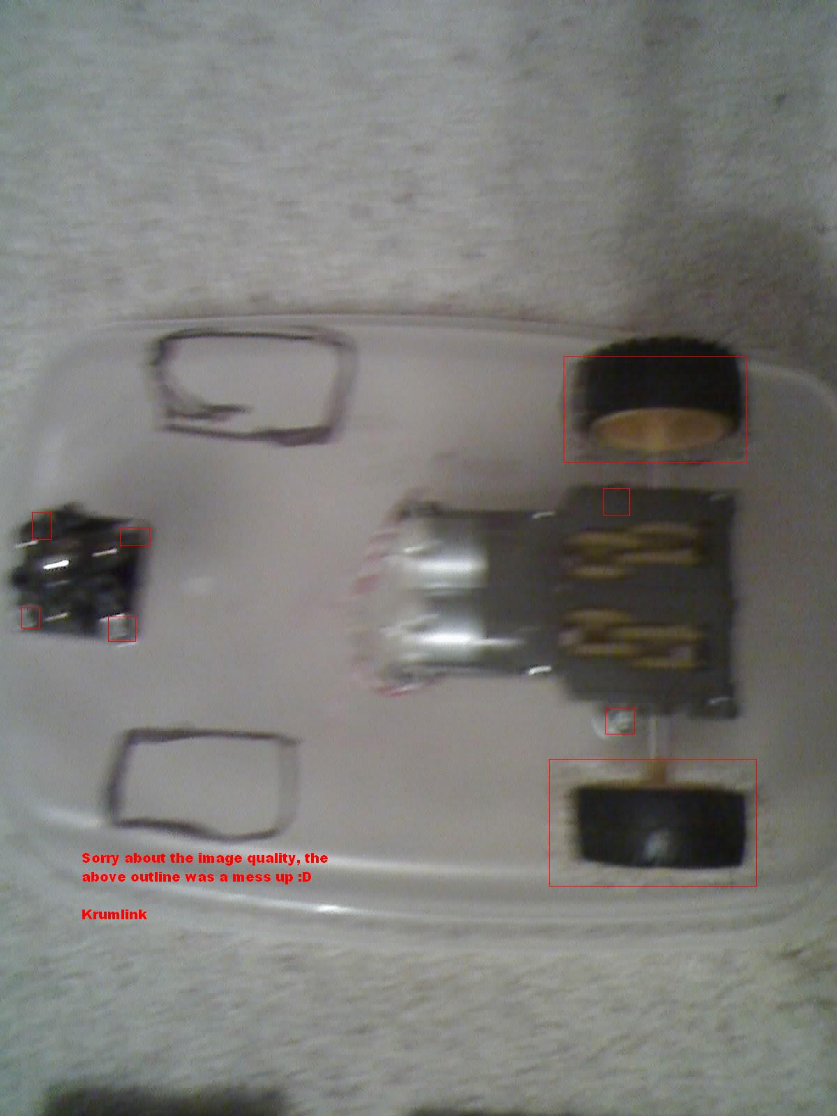

Now it is time to connect the Gearbox and caster to the Tupperware. You will not need the lid for now. Drill Holes in the front and Rear as shown in (Pic 4).
If you mess up, you always have extras :D
Step 3. Now mount the Gearbox on the tupperware and tighten nuts down FIRMLY. Be careful not to strip them.
Step 4. The caster will make the front of the robot dip slightly down, so you can use a 1/4 of an inch spacer to make it more level. It is your decisison. THen mount that into the Tupperware.

Step 9. You should be done with your Rflex1 Robot Body. Hopefully you will find some use for it.

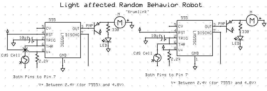

I just finished building a module, it makes the robot seem very erradic once driving. It randomly drives around, based on lighting conditions. Does it follow light? Does it follow Dark? I dont know, it just moves around. I will post schematic later.
Here is the newest Module, be sure you follow the directions on it.
