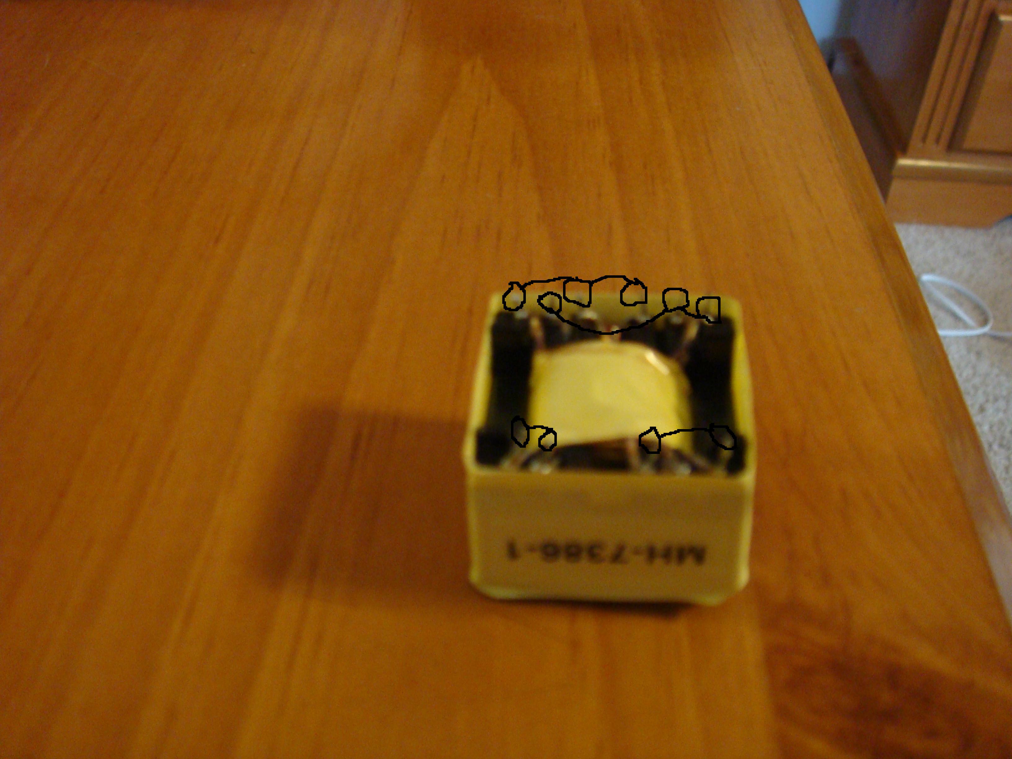

Here's the 10-pin transformer mentioned above. If you click on it so it's magnified you can see where I've marked the shorts between pins:

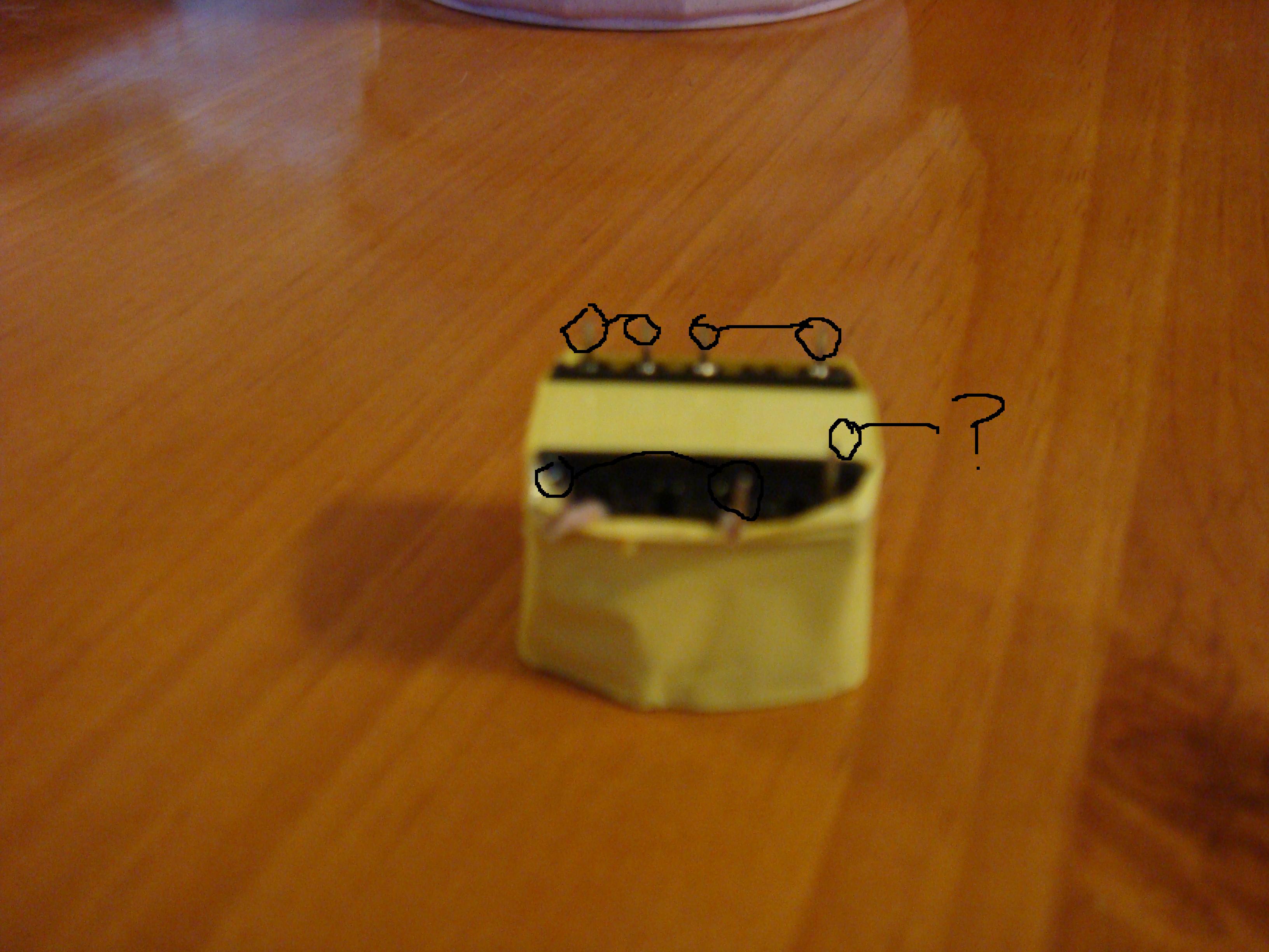

Another 7-pin that I desoldered with shorts marked:

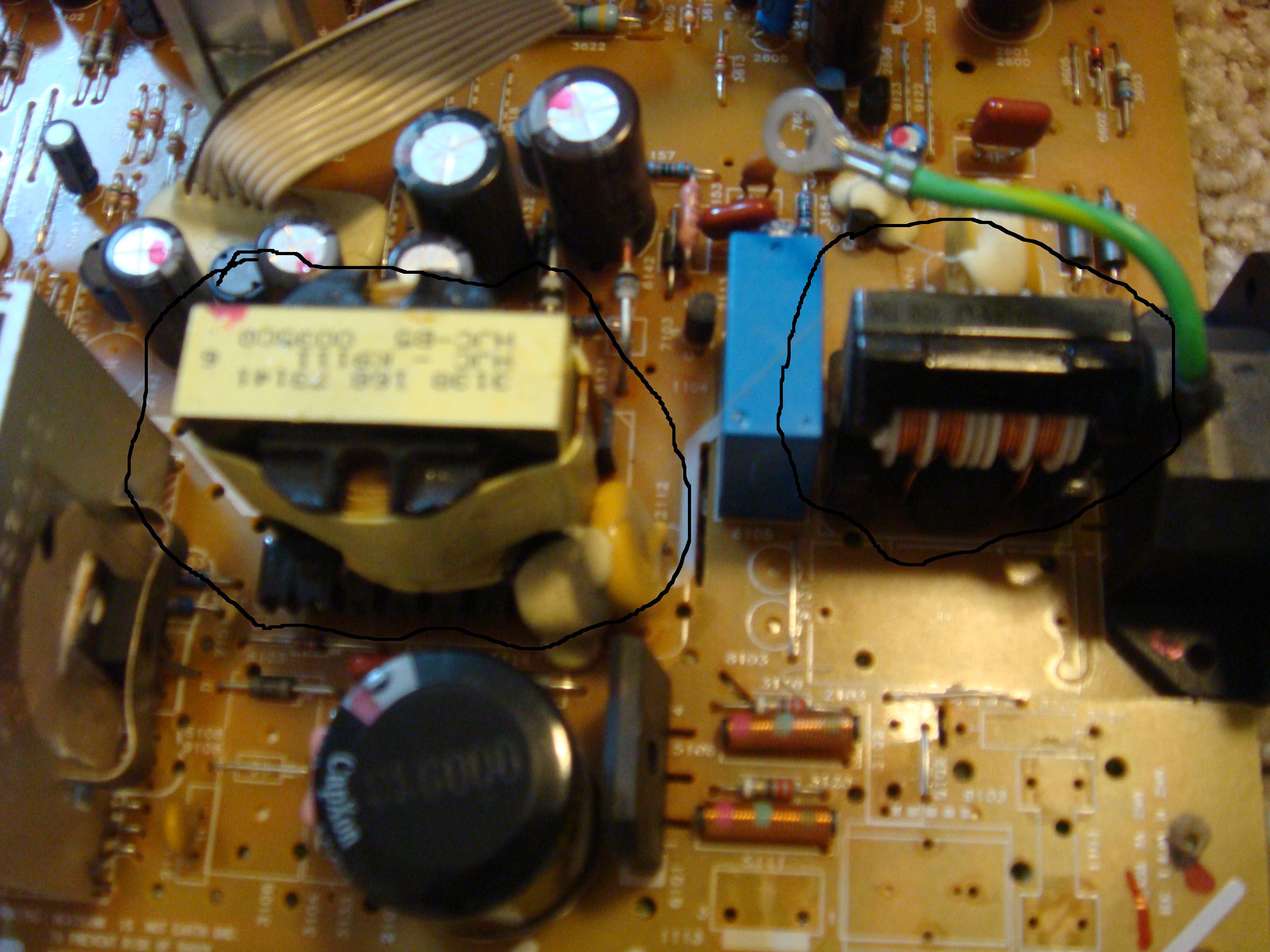

And a somewhat intact power supply circuit with a similar layout- One 4-pin transformer near AC in and a larger transformer with more pins after rectification. On the original power supplies I desoldered the 7 and 10 pin from, the 4-pin near AC in is labeled as LF01. This is actually the main board from a 110 VAC in CRT monitor:

As I've already salvaged most of the components off of the original circuits, I can't test them out and see how they operate and can't provide schematics.
What I was hoping though, was that from looking at which pins are shorted together, something might be figured out as to how they're supposed to be connected in a circuit.

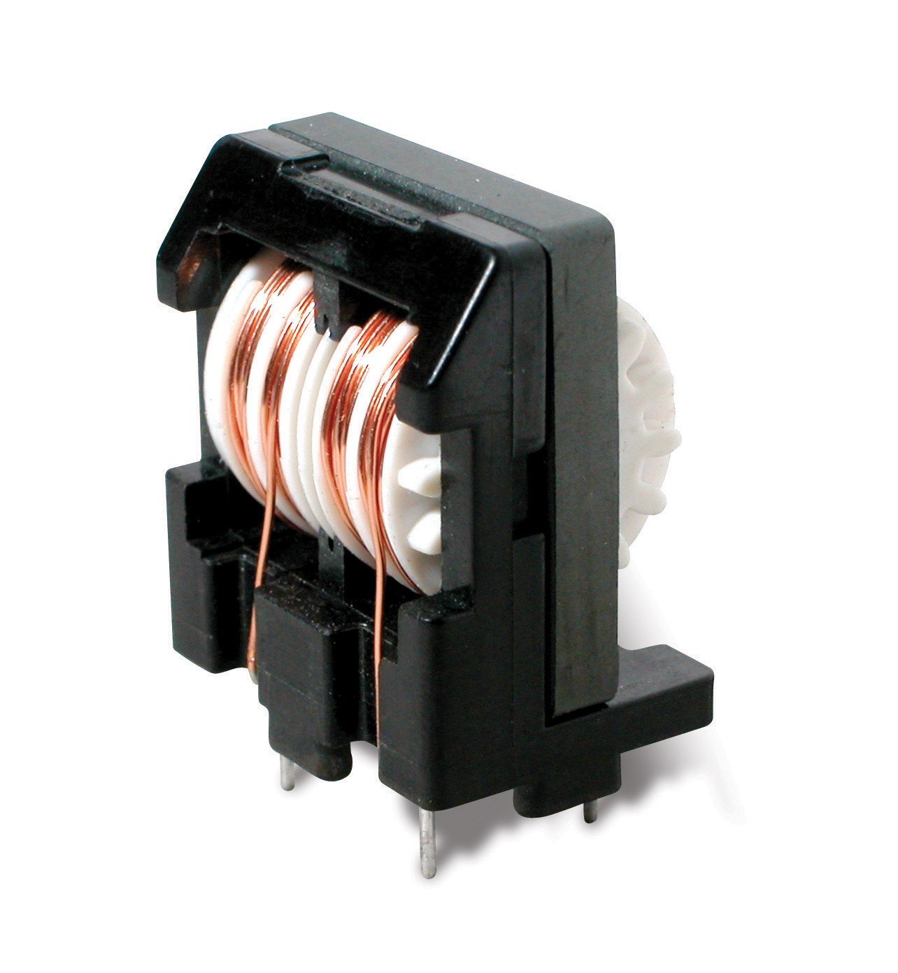

EDIT: the black one with the four white spools, I think, is a line filter. I seem to recall seeing one used that way.

Great, thanks. The LF symbol next to the Line Filter makes perfect sense and searching the web for a line filter here's what I get:
That looks exactly like what I'm seeing at the AC in for all of these power supply circuits.

The way you drew the circles on those diagrams doesn't seem too weird though, the first one looks like two center tapped coils on the one side with six connectors, and two separate coils on the 4 wire side.
The second 7 pin image looks like a primary with a feedback coil (the 4 pin side) the feedback coil is the closer two pins, and a single output at the other side with the third leg on the other end being not-connected and just there for package support.

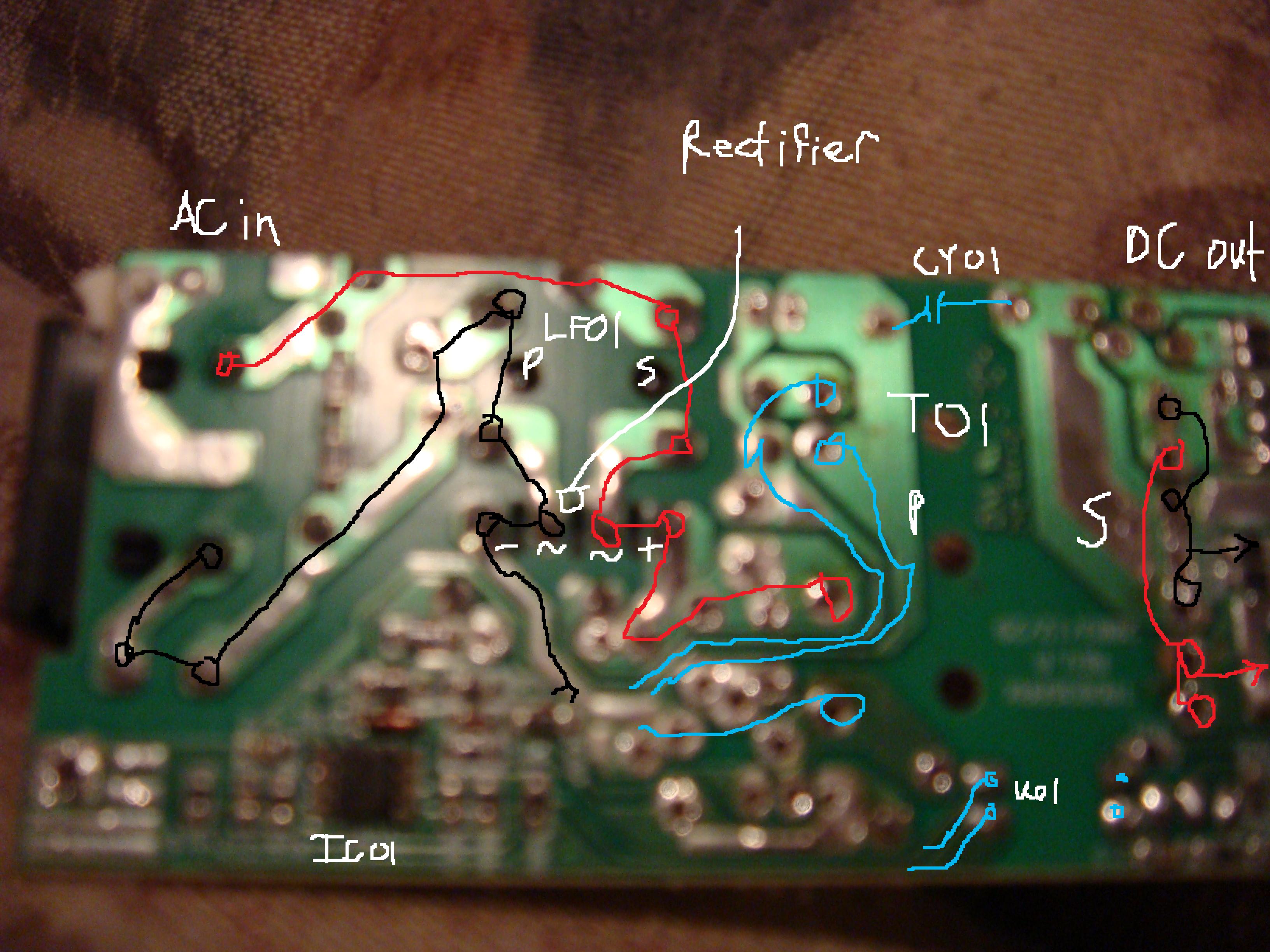

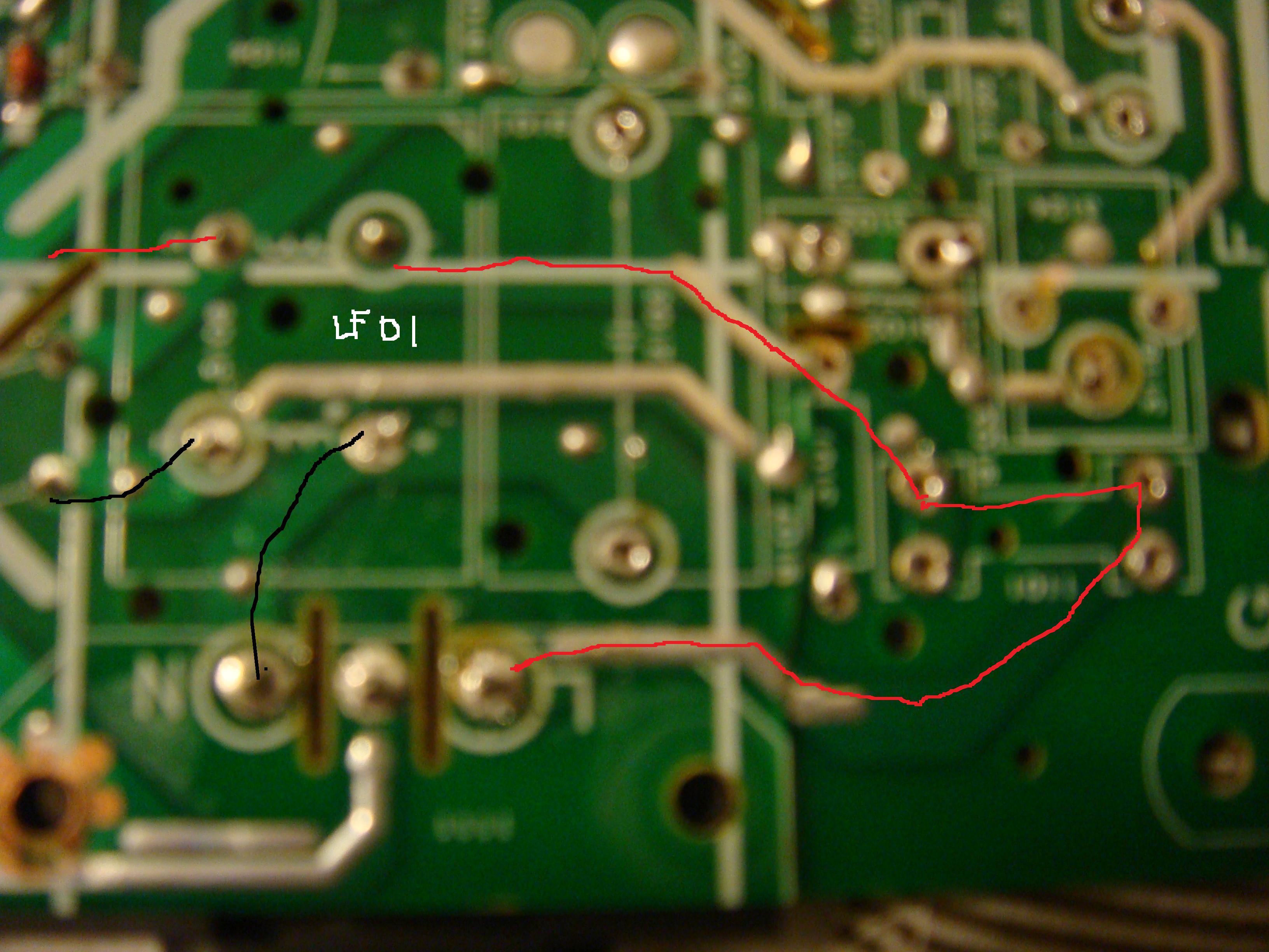

Ok, I double checked the original circuit where the LF was used and I had the sides of the transformer mixed up. It's actually 1.4 ohms between the 2 pins on the primary, and 1.4 ohms between the 2 pins on secondary. Looking at a couple of circuits I traced from AC in to the LF. I get the primary of the line filter connected to neutral and secondary connected to phase. Maybe I should take some pictures tomorrow to make this less vague. Is the line filter's only use here to isolate the circuit from the house's AC power?
About primary and secondary, I'm just referring to which side was used as primary or secondary in the original circuit.
To give a clearer idea of the circuits I've been talking about, I've attached some photos.
Here's a clearer picture of how the line filter is put in right after AC in, with lines drawn to show N (neutral) going to primary and L (phase?) going to secondary: (click to magnify)

And the circuit I took the 10 pin transformer out of, with LF near AC in, a bridge rectifier and then the connections to the 10 pin transformer: (click to magnify)
