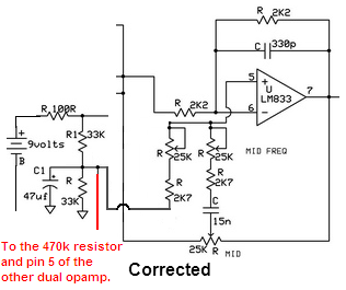

Ok here is a passive/active set up im planning on making as an internal preramp and EQ for my bass. The passive section features a pickup blend pot, tone and volume. The active section (powered by a 9V PP3 battery) features, 3 band EQ with Mid sweep and volume.
I'm having a bit of trouble working out the input stage. I'd like the first op amp set up so that the input gain can be adjusted via a trim pot.
Also im not sure where the two leads from the battery section go to...
Any help much appreciated!

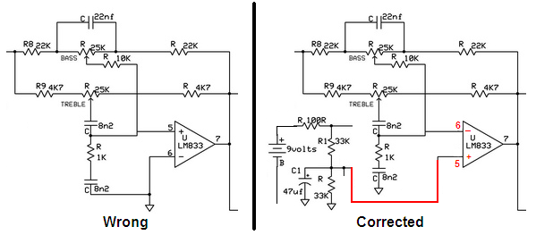

The first opamp must be a non-inverting type that has a high input inpedance. Its gain is adjusted by the value of its feedback resistor.
The second opamp is wrong. Its input pin 5 should be connected to the junction of R1 and R2, not ground.
Ok here's the revision with the 2nd op amp inputs fixed.

Instead of connecting the non-inverting input pin 5 of the second opamp to the junction of R1 and R2 as I recommended, now the second opamp has positive feedback and is an oscillator or its output latches high or low.
The dual opamps need to be powered. Look on their datasheet to see where to connect the 9V battery.

The second opamp has positive feedback instead of negative feedback so it won't work.
It also has one input connected to ground so it won't work.
The dual opamps need filter capacitors from their pin 8 to ground.
If you would be so kind, could you take a moment or two , to stick my diagram into photoshop or something and scribble in the corrections that it needs?
The second opamp is corrected here:

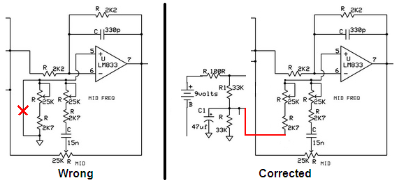

I just noticed another error. The mid-frequency has the opamp's pin 5 grounded.
The 2.7k resistor should be connected to half the supply voltage.

Thanks again! Should both of these corrected connections go between the 33K and 470K resistors? or after the 470K resistor like the above schematic?
Apart from this, how is it looking?
The two 33k resistors and the 47uF capacitor are doing a lot of things, maybe too many things. Usually the circuit has a positive supply and a negative supply then "half the supply voltage" is 0V instead of using two 33k resistors and a 47uF capacitor. Another way to make a "half the supply voltage" is with another opamp.
Try it. If the bass sounds strange or if the circuit oscillates at a low frequency then another opamp is needed to buffer the "half the supply voltage".

Why did you disconnect the 470k resistor from pin 3 of the first opamp? It biases this opamp at half the supply voltage.
Pin 5 of the second opamp must connect to the junction of the two 33k resistors and the 470k resistor and the 47uF capacitor.
Horray! The circuit is finally fixed.
