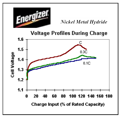

Assuming a fully charged Nimh cell is around 1.2v,then 6 of these will equate to 7.2v.
Please do not assume things that are wrong. Look it up.
In Energizer's Ni-MH battery applications manual they show that their AA cell's voltage peaks at 1.55V when it is charged at 1C. Then the total for 6 cells is 9.3V.
Fair comment...
But I then didnt specify any particular brand of cell.....
Nothing wrong with erring on the side of caution......
The brand doesn't matter. Ni-MH is Ni-MH. They are all the same.
