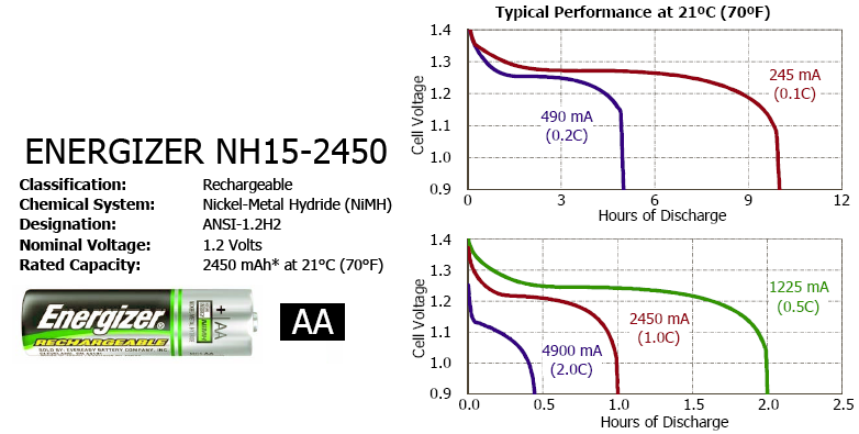

Look on the website of a Ni-MH battery manufacturer like Energizer. They have detailed datasheets for every battery cell. They also have a battery applications manual (charging and discharging details).
They sold AA Ni-MH cells that were 2500mAh but now they sell Ni-MH cells that hold a charge for many months and are 2450mAh. They sold 2000mAh cells many years ago so maybe your cells are very old?
The graphs on their datasheet for AA Ni-MH cells shows the voltage slowly dropping with various durations when the current is changed.
The mAh spec barely changes when the current is changed. They supply 2.5A very well.

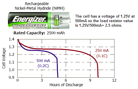

mAH or AH is the capacity of the battery, just like liquid measurements like milliliter and liter. With batteries the capacity depends upon the discharge rate and it can vary between battery chemistries. For example sealed lead acid batteries the AH capacity is based on a 20 hour discharge rate. If you try to discarge this type of battery at is AH capacity it will only last about 1/2 hour. Connecting the same AH batteries is series increases the output voltage but the AH remains the same.
Simply look at a battery manufacturer's website and see the datasheets.

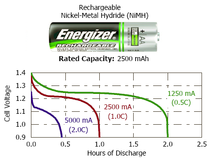

Energizer shows a Ni-MH AA cell at various discharging currents.
