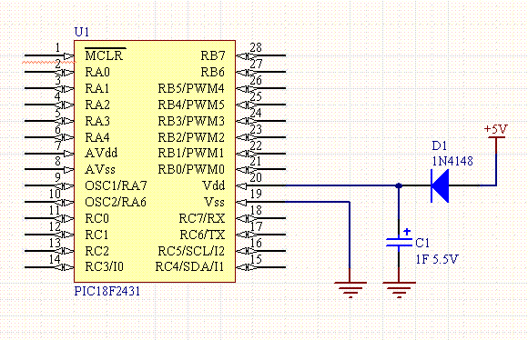

A 9V Ni-Cad has a capacity of only 120mAh and a recommended charging current of only 12mA for 14 hours. They say that a trickle charge current of 12mA won't hurt it but I think it is too high.
This is what I do.
**broken link removed** is the capacitor I use.
