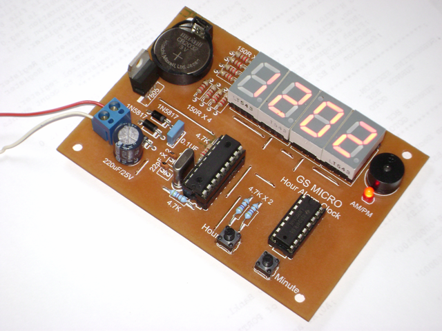

Do you need a separate IC? You can connect your 3v cell via a schottky diode, that will give you plenty of power for ram retention during "deep sleep".
Now since your sleep modes comes when the battery is very low, surely your PIC24 is monitoring battery voltage? So then the PIC detects battery is lower than X volts just put it into sleep. Job done, total parts needed; 1 schottky diode.
I'm doing similar thing what RB suggested.
To report the switch over action, a simple comparator should do the job. All you have to do is set the comparator threshold to a level that you choose for switch over. Once the threshold level is crossed, the comparator's output will assert and signal the microcontroller that the switch over action has taken place.
