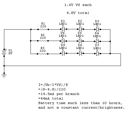

I have a 9v battery that can handle one, two gets really dim, and three isn't lit at all. Should I be wiring these in parallel? I want to light ten.
What color LEDs? If you're talking about three white LEDs, you're right, it won't work. Three of any other color would work with the appropriate current limiting resistor. You ARE using a resistor, right? But if you want to power ten LEDs, with a 9V, white or otherwise, you're going to need a series-parallel combination. Five branches of two LEDs each would probably be best. EACH BRANCH WILL NEED ITS OWN current limiting resistor because LEDs in parallel without a resistor will not share current properly.

I may have misled you. LEDs in parallel are acceptable if there is a resistor in series, see the diagram posted by John Sorensen on Mar 19.
Others have commented on the battery configuration. Two 9 V in series would be workable as you could connect 5 LEDs in series (and a series resistor) in parallel with a similar combination. 4 AA would also be better since there would be less energy wasted in the resistors. But it would be more suspectable to battery voltage, ie. as the battery ages, the LEDs will start going dim sooner than with 2 X 9 V.

For the LEDs, should I wire them like John's design, but with 2 rows of 5 instead of 3 rows of 3? Would I still use 220 resisters?

No, two 9 Volt batteries in series gives you 18 Volt. 5 LEDs is series will require about 9 Volt assuming they are red, so 9 Volt is dropped across the resistor. So a resistor of 680 Ohm would givve a LED current of about 13 mA or 26 mA for two LED strings.
I don't know why a 9 Volt battery could not power 3 LEDs in series. What series resistor did you use?
Len
There's no reason to use two 9V. In series there would be more power wasted and you'd be right at the absolute maximum voltage for the 555 (above it with fresh batteries). In parallel, well, what's the point?
As for the 555, that should be good to go. It can "sink" puh-lenty (plenty) of current. I would use 5 parallel branches of two LEDs and a 330 ohm resistor in each branch. Tie all the branches together at the top and bottom. The top (the anode side) goes to Vcc (+V) and the bottom goes to the output of the 555 (pin 3). The total current sunk will be about 45mA and the whole circuit will draw between about 55 and 60mA while the LEDs are on (pin 3 low). Depending on the duty cycle, a 9V battery should last in this circuit for about 1 to 4 hours. If this is a full time show, consider a wall-wart or you'll go bankrupt keeping it in cells.

I don't know why 3 red LEDs in series with a 330 Ohm resistor would not work on 9 Volt. The current should have been about 10 mA which is more than adequate. Was the battery fresh?
For 9 Volt, you would need 6 AA batteries.
For 10 LEDs you could connect them in 2 pairs of 3 and 2 pairs of 2.
The resistor for the 2 LEDs would need to be 560 Ohm to give 10 mA and use a 330 Ohm for the 3 LED strings.
This will require about 40 mA, so for a 24 Hour operation you would need a battery with at least 1000 mAH capacity. The 9 Volt batteries only have about 110 mAH capacity.
6 AA batteries with 1200 mAH capacity would be a solution.
