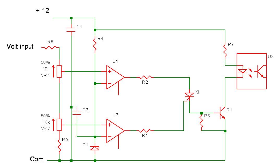

I like using this circuit for toggling actions based on voltage differences. I have a basic dicription of how it works on the grid tie inverter thread.

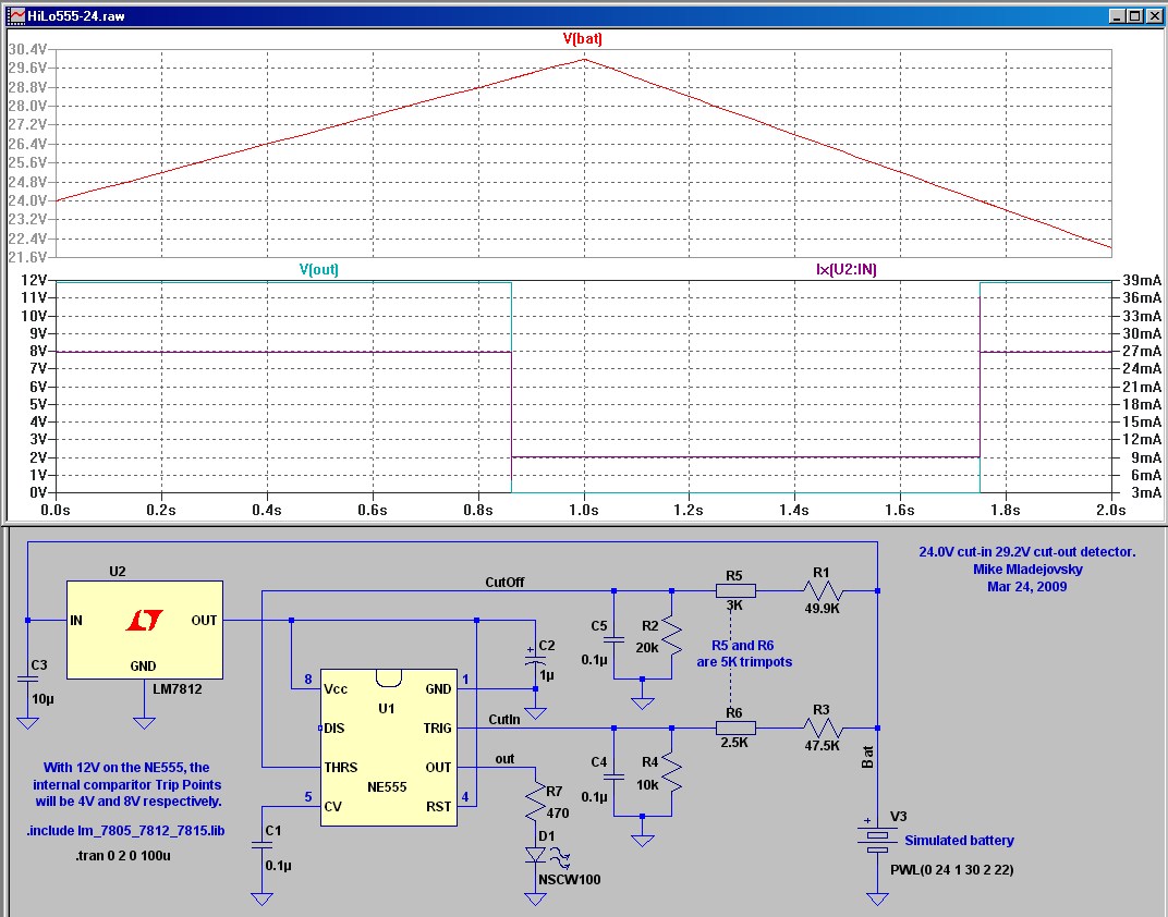

This thread outlines a simple voltage detector which has adjustable Cut-in and Cut-out. The circuit I developed for that application was for different voltages, so I have modified it for your application: As depicted, the trip points are 24.0V and 29.2V. The trimpots will fine tune these.
I agree with Chemlec. You cannot terminate charging of a lead-acid battery by simply measuring the voltage during charge. After the battery reaches ~29.2V, you should be monitoring the current flowing into the battery, and then terminate the charge when the battery current drops to ~25% of what it was when the battery first reached 29.2V. This is called the **broken link removed**.
LONG LIVE DISCRETE COMPONENTS!
I like your idea of using the SCR as a latch.
