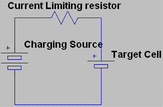

I have been reading all previous threads on Battery Charging circuits and was wondering that in a basic charger circuit which requires current to charge, how do I maintain the current,
If I place a current limiting resistor, shall not form a potential divider with the cell and give a low voltage drop across the charging cell?
I am assuming that I can consider the resistance of the cell large as I am connecting it parallel to the charging source. The current form the target cell shall oppose the current from the source cell. And as the target cell charges, it's voltage level shall incerease and so shall it's current delivering capacity. And it's "resistance" shall further increase. Is my assumtion correct?
So do I need to decrease the voltage output across the terminals of the source as the target battery charges?
And how much current would a NiCd cell need for fast charge(1/4 rated?) and trickle charge(1/10 rated?)?
Please guide me...
Thank you.

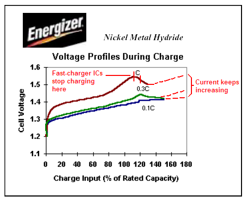

The rechargable cell's internal pressure, temperature and voltage rises as it is charged.
Energizer don't make Ni-Cads anymore but have their datasheets, a tutorial and the same for their Ni-MH cells. They say that many conditions will cause a cell to vent or explode if charging is not stopped when a cell is fully charged at a fast rate.

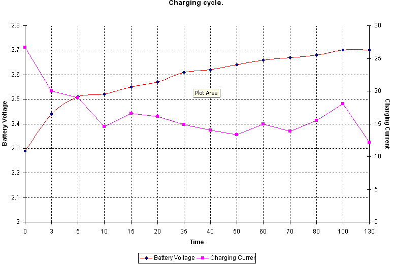

Okay, I tried to charge the battery using a constant current source.
My target is two Ni-Cd 700mAh cells in a series, I used a 23.5ohm resistor in a series and the source voltage of 3v. The initial voltage was2.29v and my target is (1.35v x 2) = 2.7v
The initial charging current as measured was 26.7mA and reduced to 16mA within the first 10 minutes. This reduction included a lot of fluctuations. The current reduced to as low as 14mA and increased to 20mA during this period. After this the charging current decreased steadily. The battery temperature remained at room temperature.
After 40 minutes, the target battery voltage was 1.62v and current 14mA.
Can anyone explain me this phenomenon and enlighten me with their comments?

You should charge NiCd's with constant current, you were using a VERY un-constant current.
For simple chargers a resistor is all you need, BUT you need a much higher voltage feeding the resistor to make the current more near constant. A simple constant current source is JUST a resistor fed from a high voltage - the higher the voltage the more nearly constant the current is!.

The LM317 is fine, But Your Source Voltage is TOO LOW.
Use 6 to 12 volts.
With only 3 volts in, You have lost half that in the Regulator.
An LM317 current source needs about 1.5V for the minimum voltage across the regulator at low current and an additional 1.25V across the current-setting resistor, for a total of 2.75V more than the output voltage.
Since two Ni-Cad or Ni-MH cells are nearly 3V when fully charged then an LM317 current regulator will need a min input of 5.75V.

Look at Energizer's graph I posted. A cell is about half-charged with a very low current when its voltage reaches 1.35V. Over and over, Energizer recommends sensing the cell's temperature rise as it approaches full charge to reduce the charge rate.
