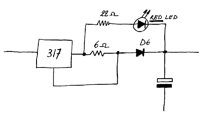

I had one question rise up before me during all this, how do I hook up an LED that will be on during Load/charging operation ?

Battery charger indicator.
Hi Frosty,
Maybe there is a way to put D6 to good use.
The voltage drop accross R1 is 1,25 volts when charging.
That is a little too low to light a led, but if you put the
useless D6 in series with this resistor the total voltage drop
will be close to 2 volts and that is enough to light a led.
The 22 :eek:hm: resistor was calculated for a 10 mA current
through the led, but this might vary slightly because the
voltage drop accross a red led varies from 1,6 to 1,8 volts.
So check it out and adapt the value of the 22 :eek:hm: resistor
to let the led light as bright as the other one.
on1aag.

I updated the circuit.
Thank you very much for all your assistance in this design. I will go ahead and start building this circuit on Tuesday. I still have to design the PCB layout for this circuit using Eagle (that might take a while), so hopefully I will have it working by Wednesday.
