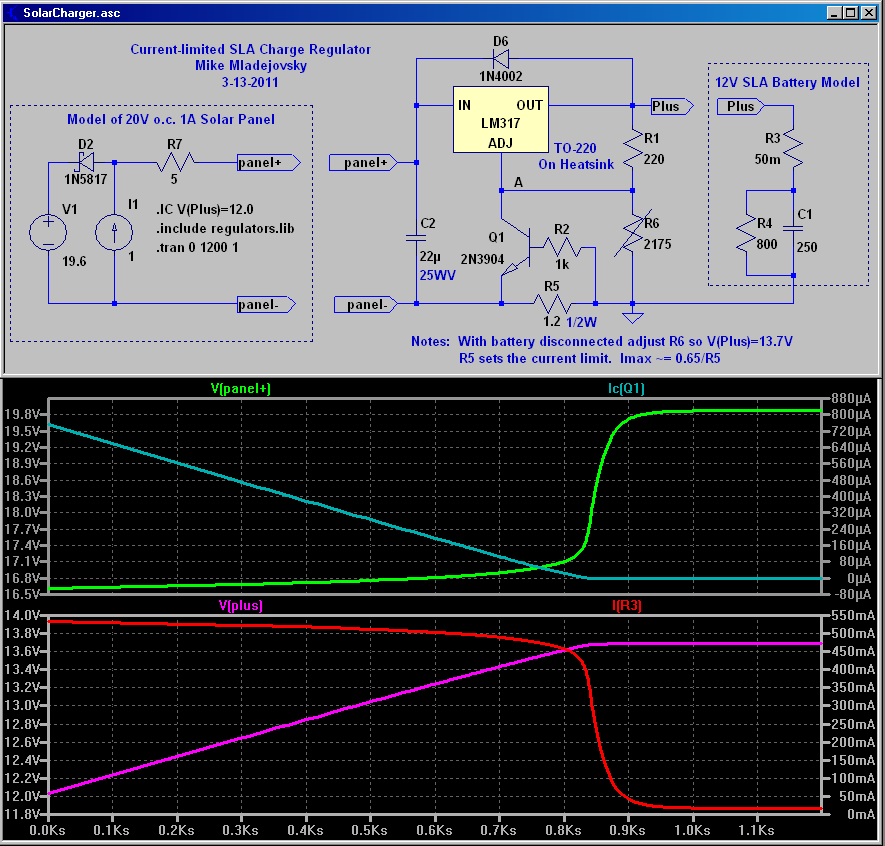

Here is a simpe SLA charger circuit:
Start with this. It is self-contained without intervention from the AVR. You can use the AVR as a supervisor, to disconnect the load to protect the battery when the sun doesn't shine. We can modify the circuit later to enable the AVR to speed up re-charging.
In the meantime, start simple. This basic circuit will limit initial charging current to ~ 1/2A (R5 = Vbe/Ic). It will also limit the maximum battery voltage to 13.7V (adjustable with R6) after the current tapers.
i have a new idea :charging battery with solar panel (that have 21 volt open circuit) until battery voltage reach to the 13.7 and then stop charging .what is your opinion?
Kazem,
That is EXACTLY what the circuit I posted above does!!!
You are either very inexperienced, or are a Troll.
