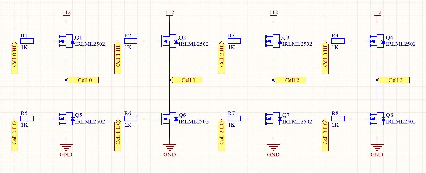

Ok, forget about capacitors then...
Is this ok?
Q1, Q2, and Q3 controls passive ballancing for each cell, but what i worry about is my charging "section". With 8 mosfets. I dont know if that would work that way..

Bit better, but still rather vague as to the battery connections - are they from Cell0 etc. to Gnd?.
If so you appear to be connecting them directly to 12V to charge, and the bottom FET's short them out destroying everything?.

I have corrected the schematics (balancing part), so here it is again.
So lets say i want to charge cell 0 to cell 1 (0V to 4.2V). I would turn on Q8 and Q5, and turn off Q4 and Q9. Is this correct?

The entire scheme looks highly dubious, and EXTREMELY prone to expensive and dangerous mistakes.
Are you not able to charge LiPo in series? - assuming not?, I would STRONGLY suggest you used DPDT relays to split them for charging, and not the dangerous method you're proposing.
Please remember that the battery and the circuit can not share a 'ground'-connection. Or any other connection than that temporarily made by by your MOSFETs.
Speaking of which, are you providing sufficient gate-drive to the 'upper' devices? You may need PMOS devices there.
Are your cells permanently connected in series?
Edit: There is a serious safety issue with your circuit. You show nothing to control the charging current or monitor it, or to terminate the charging correctly. Connecting 12V across a cell via the FETs will DETONATE the cell :eek:.
Please post a video of your battery exploding in flames. Then BUY a balanced charger for your multi-cell Li-Po battery.

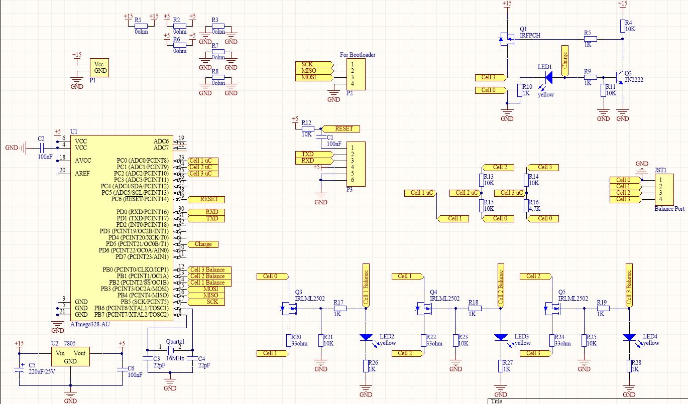

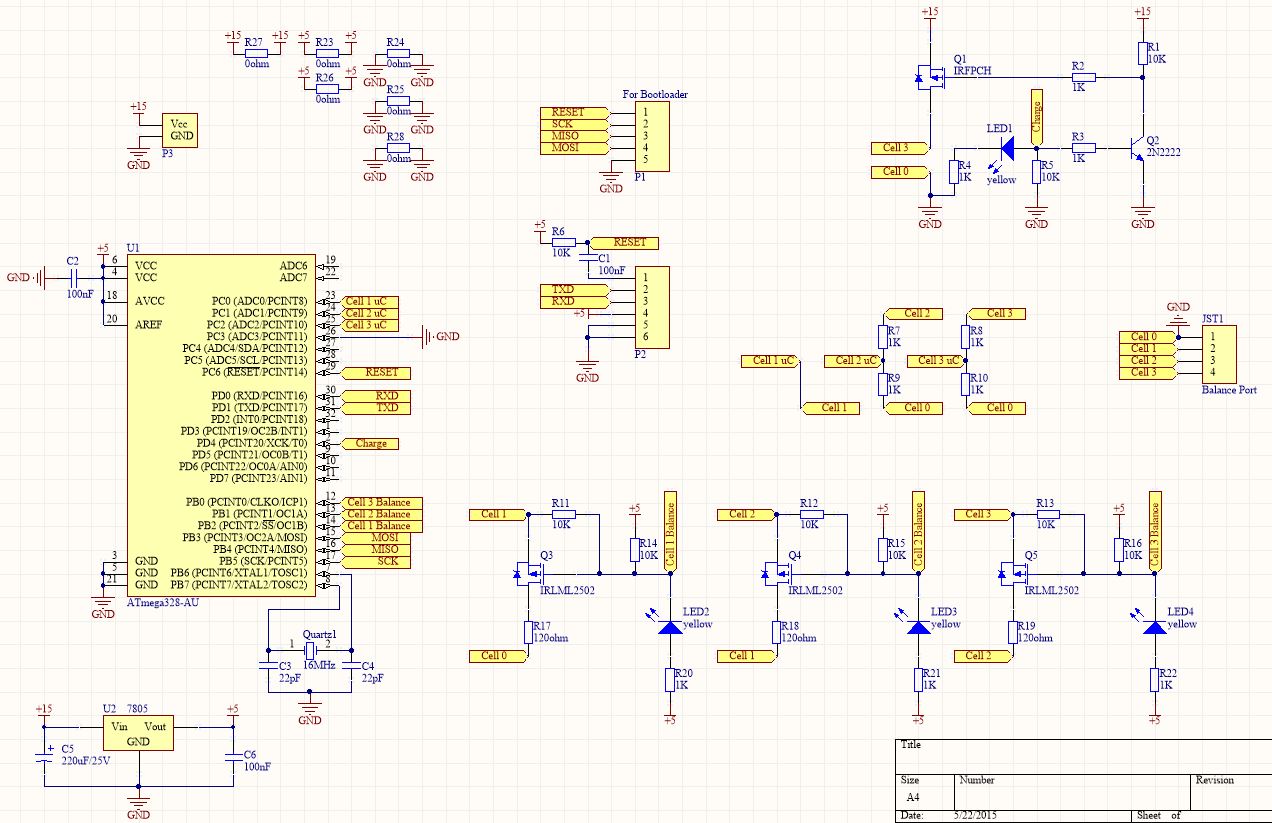

UPDATE!
I have tested all parts of this circuit again and i schematics has been completely changed! Also, i have made PCB!
Now i charge my 3S battery in series with 15V power supply. I measure all voltages on each cell, and Q3, Q4, Q5 are intended to discharge certain cells whose voltages are above the lowest cell voltage (thats from passive balancing theory). Discharging current is 0.035A (120 ohm resistor).
Charging is controlled with P-CH mosfet Q1.
I am now in the software part, cell voltage measurements are perfect, and balancing works really good (slow but good)
Charging part is still not completed but i have tested it with youst turning on Q1 and it works! I have to control it with PWM so the current would be constant but i know how to do it..
The problem now is that my PCB is ON when only battery is connected (and not the power supply too). That CAN'T happend. Because my battery will be always connected to this charger. How to stop it form working if the power supply is not connected?
You may know how your battery is connected to that circuit, but we don't. Show us.
Cell0, for example, seems to connect both to ground and to R17. Is that right?
Yes, it is. But R17 is shunt resistor, and it is "ON" only when uC gives LOW input to gate Q3 mosfet.
R17, R18, R19 are all shunt resistors that are controlled by ATmega

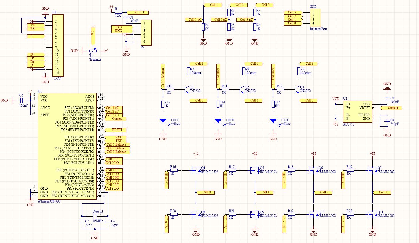

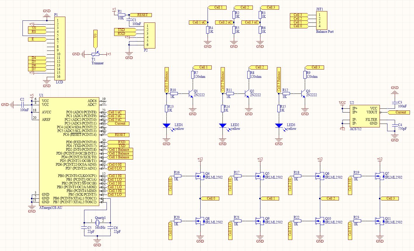

I have tested my PCB and i really dont understand what was the problem. Then i saw something.
I have put P-CH mosfets to balance part of my board, and every other circuit has N-CH mosfet there. Maybe i thought of using N-CH because i put IRLML2502 as designator, but they were FDN352, P-CH mosfets.
So i tested everything on the breadbord, and i dont see any significant current leaking (>0.001A)
I think that this may be a final version of balanced charger, and now i would be very thankful if someone would see my schematics and say if everything is wired correctly :)
When Q1 switches on....BANG! You have nothing to monitor or limit the charging current.
If your cells are series-connected then the micro won't be able to switch on Q4 or Q5 fully. Vgs should be >> Vgs(threshold).
